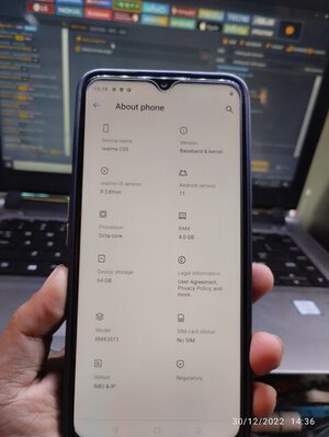

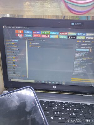

Open unlocktool
Select Oppo
Click realme c35

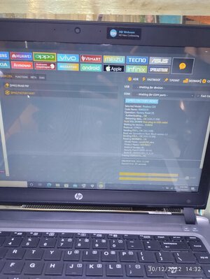

Click sprd factory reset
Hold volume down to boot

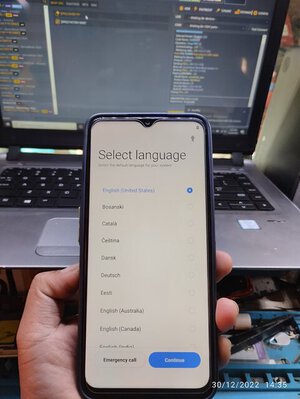

Anatayin hanggang matapos
Pag my frp same procedure
Click lang sprd Erase frp
Hold volume down
Hanatayin matapos

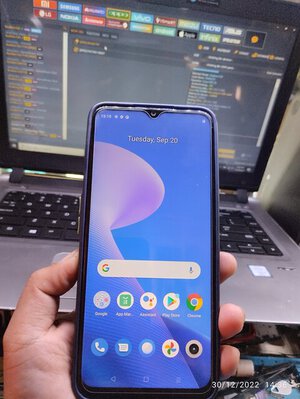

Done
