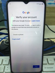

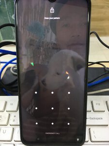

REFERENCE realme c35 passwword+frp done via unlocktool

for password - watch this video
https://www.youtube.com/watch?v=xWrJySdl9zY
for frp

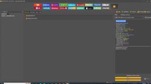

run unlocktool latest version
select oppo platform
select realme c35 spd
select brom/edl
click (sprd) erase frp
hold vol down then connect usb cable to pc

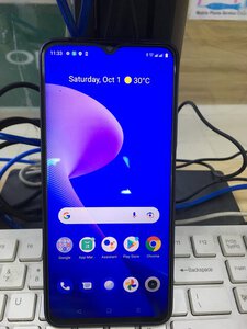

wait till operation completed.
