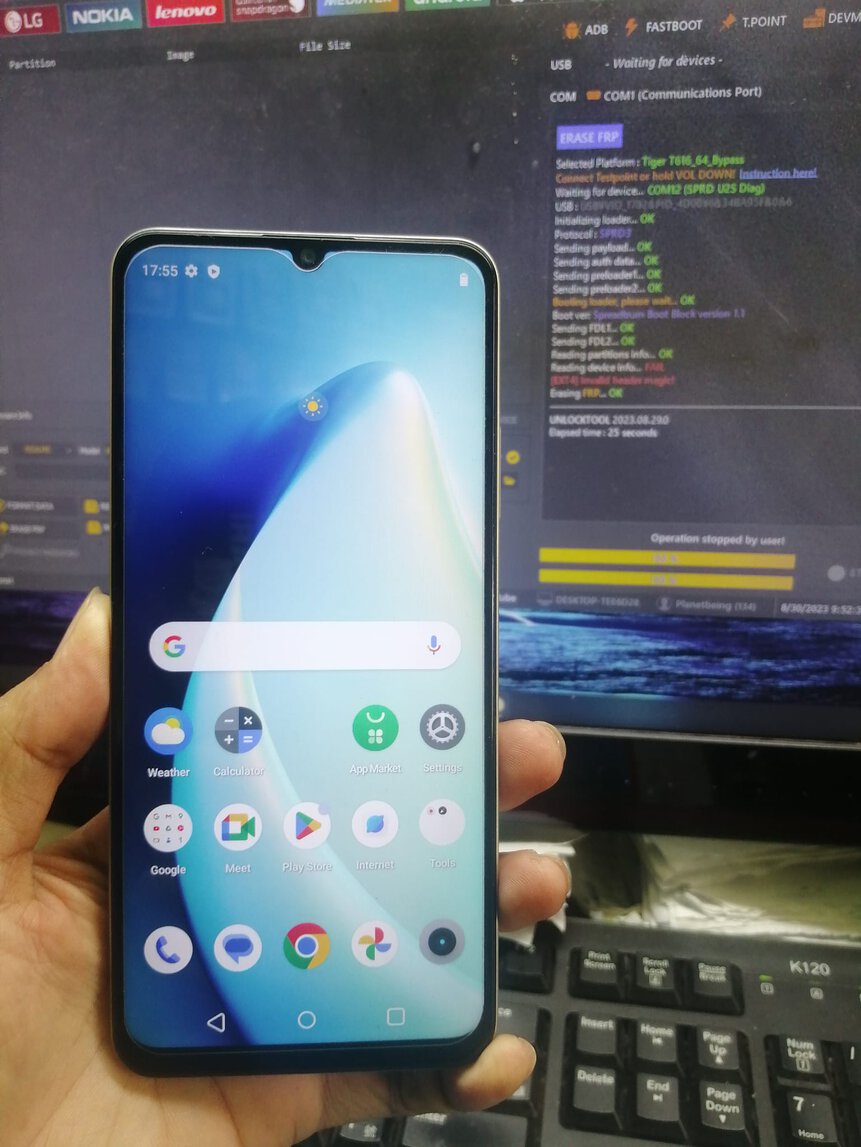

Realme C53 RMX3760 remove password Frp first in Pinoytech
Power off ang unit
press Volume up at Power sabay Need muna natin HR ang unit error kasi sa Unlocktool for Factory reset FDL error bla bla bla siguro mataas na patch sec.
after HR Open Unlocktool Go to SPD tab
Select Realme RMX3760 Remove frp
Boot Key Hold volume down and done may error yan peru basta makita mo ang Frp lock remove Ok done nayan

Sir pwede napo siyang diritso sa factory reset. tested po. thanks
