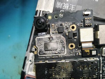

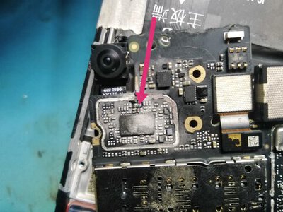

Dumating c tomer sabi patay buhay lang.. Check ko battery OK naman repair ko battery ganun padin auto viverate kahit hindi pa power on..
Check ko board OK naman sa tester kaya try q short killer un Pasok... 5.40 volt
3amp
Done usok agad
Remove lang OK na..
