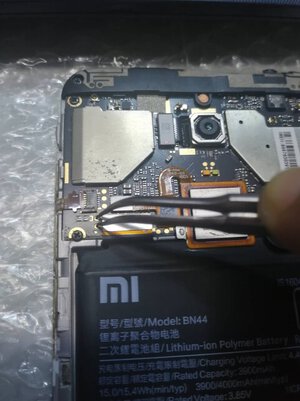

baklas unit for test point

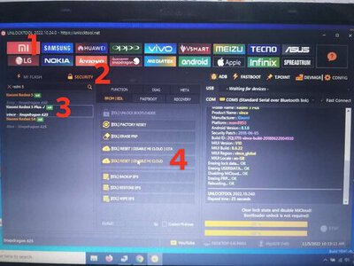

open unlock tool
1 mi tab
2 click security
3 search model then click
redmi 5 plus edl
4 click edl reset disable mi cloud
5 remove battery connect tp

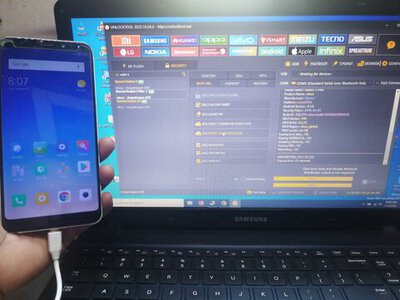

6 connect usb cable.

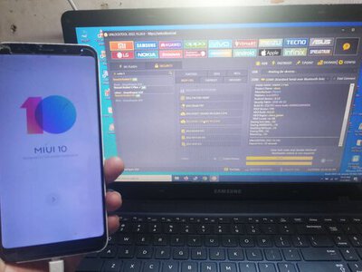

done.

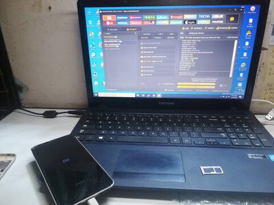

3 to 5 min.nakahang muna sa logo hintayin lang
