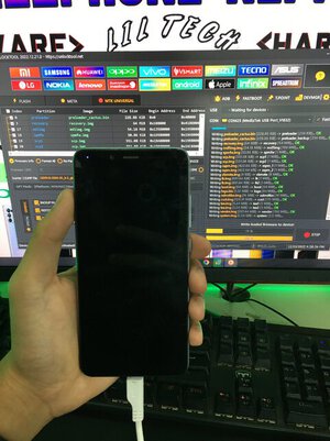

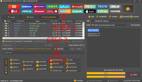

STEP 2: OPEN UNLOCKTOOL POWER OFF ANG UNIT, CLICK MEDIATEK TAPOS UNLOCK BL THEN SALPAK CABLE SA UNIT WAIT UNTIL DONE.

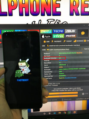

STEP 3: ENTER FASTBOOT MODE ANG CP THEN CHECK KUNG NAKA UNLOCK NA ANG BOOTLOADER BAGO E FLASH

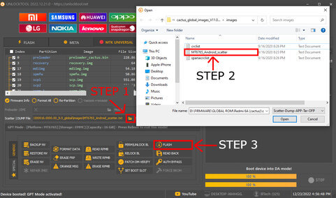

STEP 4: POWER OFF ULIT ANG UNIT THEN LOCATE YUNG DINOWNLOAD NA FIRMWARE, CLICK FLASH TAPOS SALPAK ULIT CABLE SA UNIT WAIT TIL DONE

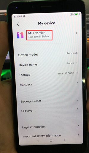

GLOBAL ROM DONE. SANA NA SUNDAN NG TAMA ANG PROCEDURE.
