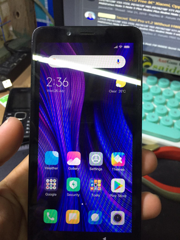

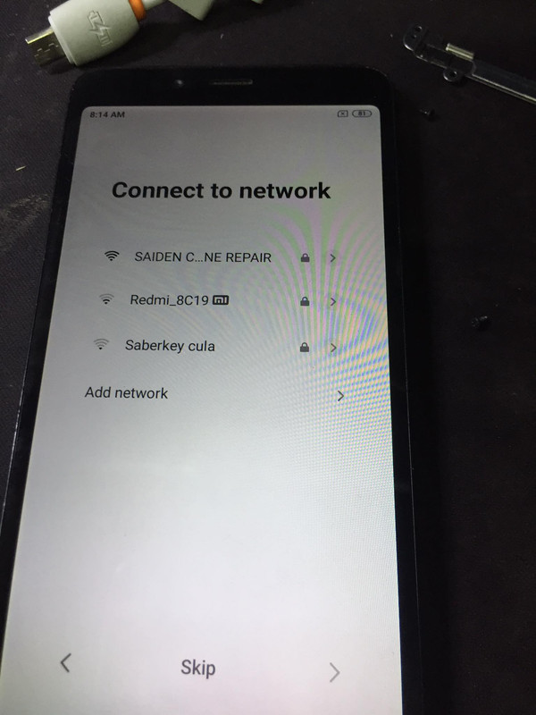

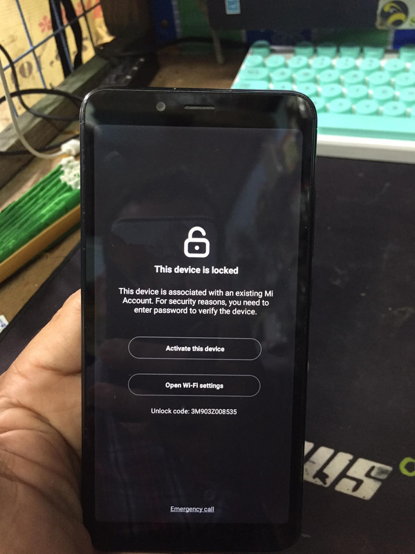

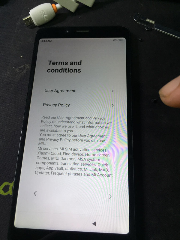

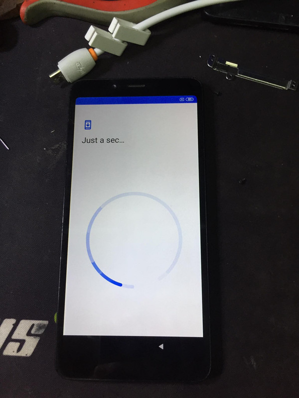

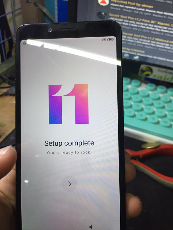

temporary remove Mi account
hinde nga lang magamit
ni tumer ang wifi nya
saka data sabi nya ok\lang daw

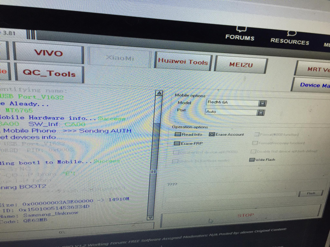

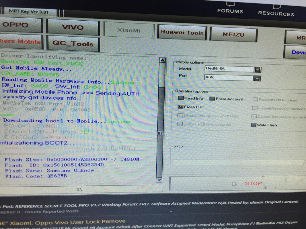

procedure
redmi 6a xioami
Mi account with frp
opin MRT.VER 81
/CLICK SELECT/XIAOMI
/SELECT;REDMI 6A
/CLICK [ERASE ACCOUNT
THEN START MUNA
PAG START MO HOLD MO
VOLUME UP IN DOWN
THEN USB CABLE
CONNECT
WAITING MO MATAPOS
SAME PROCEDURE SA FRP
