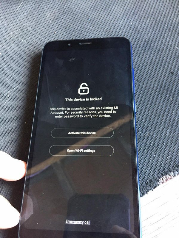

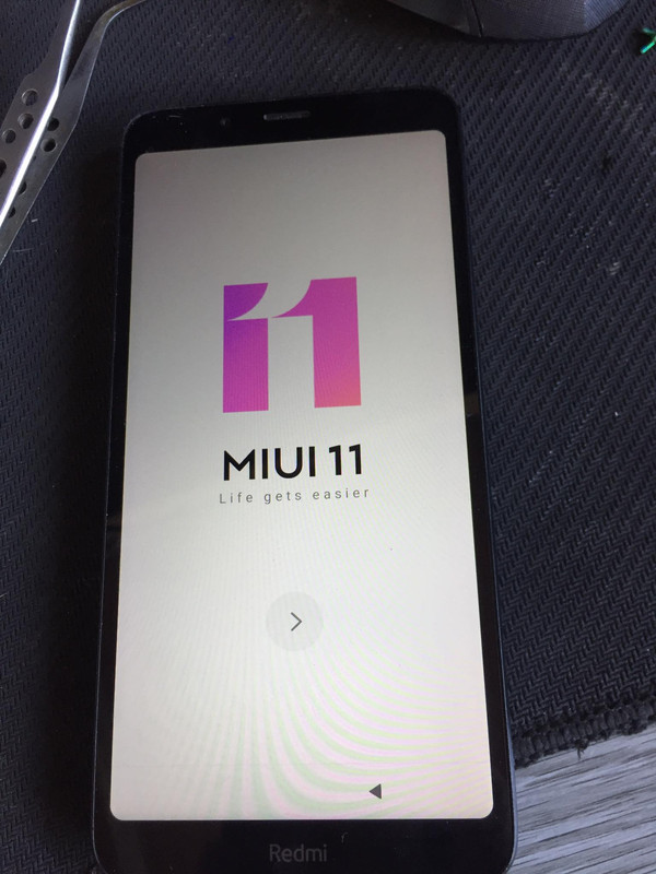

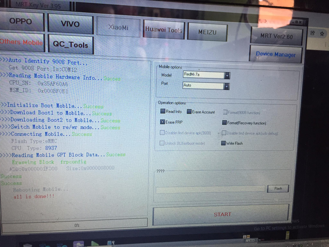

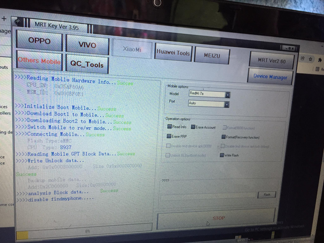

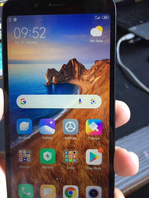

PROCEDURE
REDMI XIOAME 7A
MI ACCOUNT
BAKLAS UNIT TP
OPIN MRT.3.95
CLICK/XIOAME
SELECT Redmi 7a
CLICK ERASE ACCOUNT
TP MUNA THEN
CONNECT USB
START MO WAITING
DONE
PAREHO LANG NG
PROCEDURE SA FRP

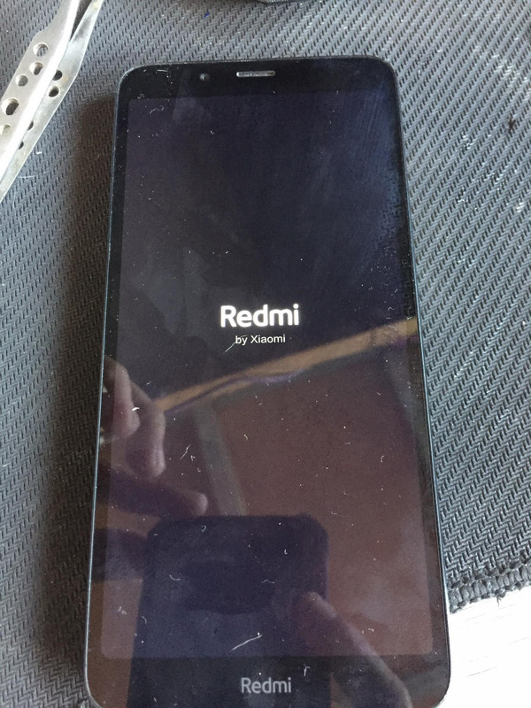

saklap dead sakin pagtapos ko frp
anung gamit mong mrt boss crack ba kc itong ginamit ko dongle pa hinde sya nag crack
