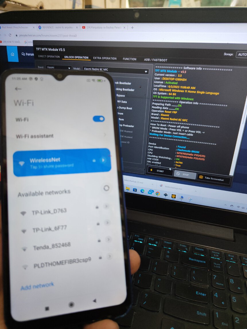

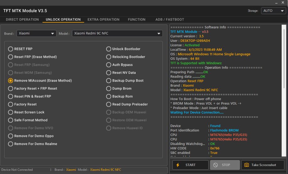

Issue: Password and FRP
Procedure:
1st : Hard Reset mo muna ung phone Power and Volume Up
2nd : Open TFT MTK Module
3rd: Off ung Unit .....Click Start
4th: Press Volume Up and Down wait until Done

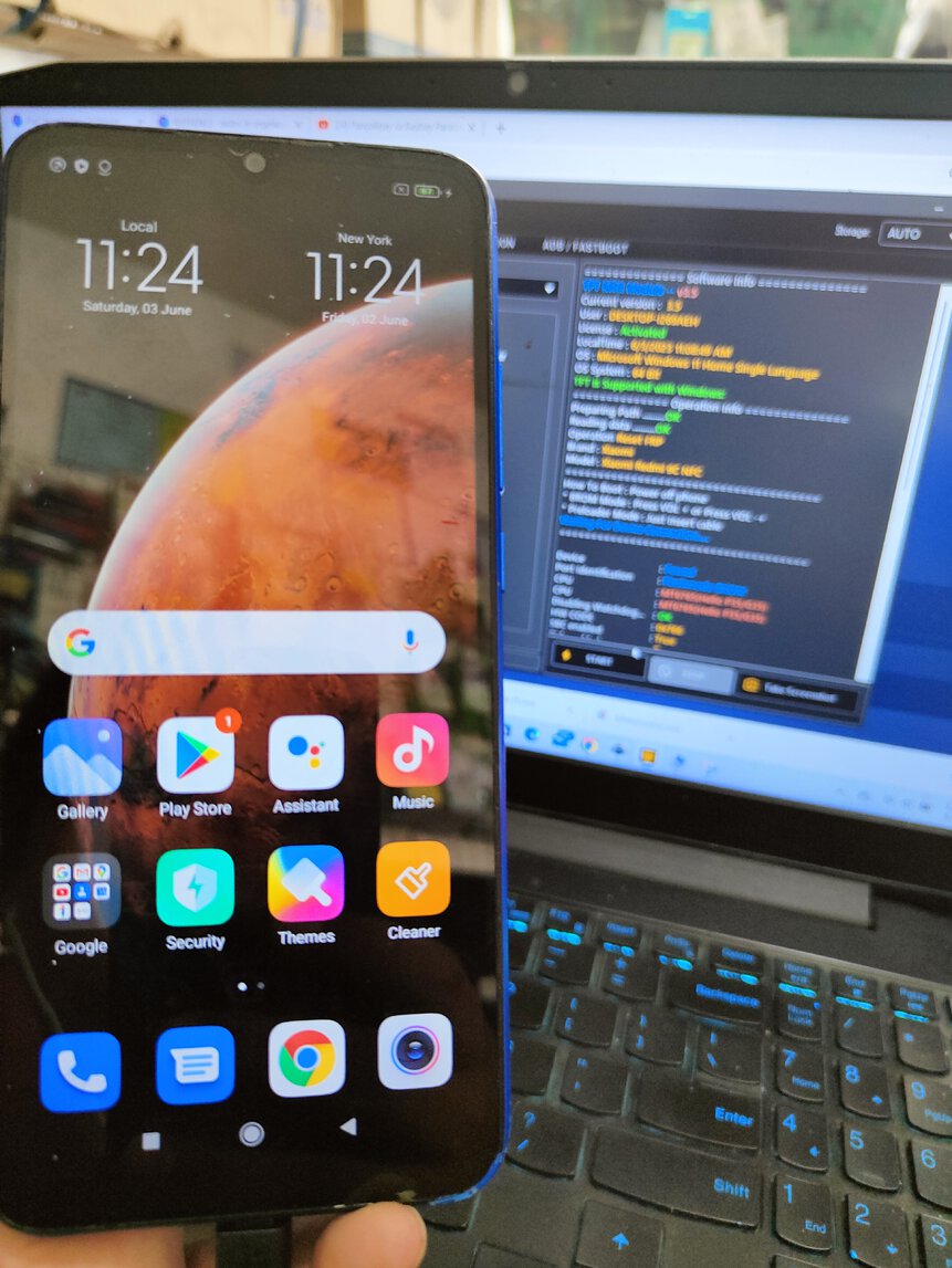

Para nman sa FRp same procedure:
Results:
wag muna connect sa wifi....
Go to About phone
Click MIUI version 4x para lumabas ung developer
Go to Additional Settings then Click Developer options
Allow and OEM
