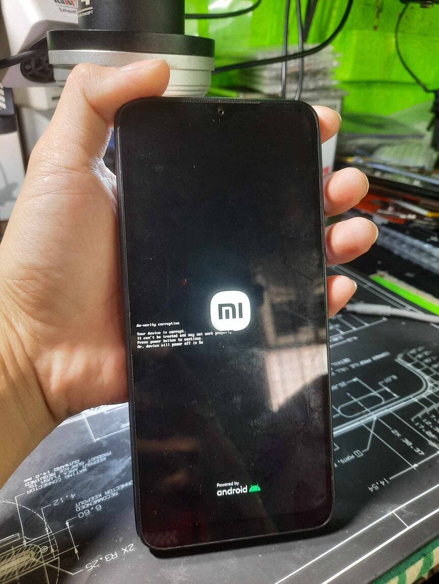

Redmi A2+ Dm verity corrupted fixed !
STEP BY STEP PROCEDURE NA AKING GINAWA PO

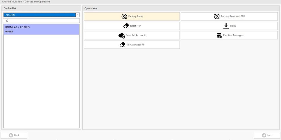

ANDRIOD MULTI TOOL​
OPEN AMT TOOL
SEARCH REDMI A2+
LOAD NATING UNG NADOWNLOAD NATING FILE KANINA​

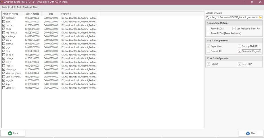

REMIND KO LANG PO PALA ICHECK PO KUNG NA UNLOCK NA SI BOOTLOADER BAGO MAG FLASH SA AKIN KASE UNLOCK KUNA SIYA SA UNLOCKTOOL BAGO KO IFLASH KUNG NAKA UNLOCK NA GO NA TAYO SA PAG FLAFLASH.​
PA NA LOAD NA CLICK NATEN FLASH
AT IHANDA SI UNIT
HOLD VOL UP AND DOWN PARA SA BOOT KEY
INSERT USB CORD PAG NA DETECT NA WAIT HANGGANG MAG DONE .

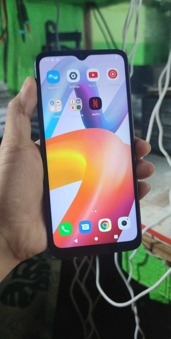

ITO ANG FINISH PRODUCT .
