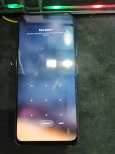

Procedure
HR to remove password Hold Power and V+
or Use Unlocktool

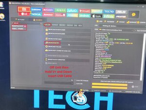

1. Select Xiaomi
2. Click Redmi Note 10 Pro China/Poco X3 GT
3. Click Factory Reset
4. Off Unit / Hold V+ & V- then Insert USB Cable

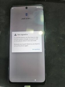

for FRP
Open Unlocktool
1. Select Xiaomi
3. Click Erase FRP
or Use Unlocktool
Open Unlocktool
1. Select Xiaomi
for FRP
Open Unlocktool
1. Select Xiaomi
3. Click Erase FRP
