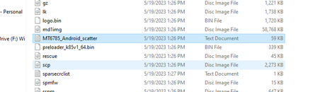

Need mo i-download stock rom para ma flash mo.
link - https://mifirmware.com/redmi-note-10s/ or hanap ka ng iba.
*Open UT
*Select Mediatek module
*Select flash
*Select server
*Brand XIAOMI
*Model Xiaomi Redmi Note 10s 4G [Rosemary]
*Scatter file (Yung dinownload mo) sa file directory niya yung MT6785_Android_scatter
*Select format all + DL
*Optional Ferm Unlock DL 1st/ flash
*Select flash
*Baklas cp/ short yung test point tapos salpak
*wait mo ok na.
Check mo mga picture sa baba sa ibang ditalye.
