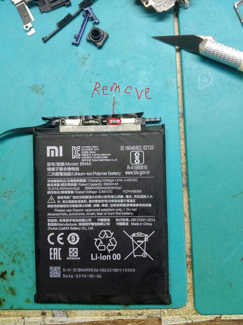

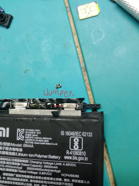

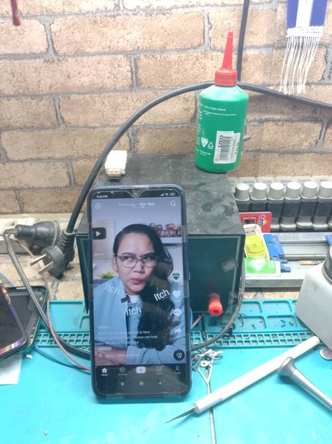

windows22 Registered Joined Jan 7, 2022 Messages 82 Reaction score 145 Points 1 Location San Leonardo Nueva Ecija Aug 21, 2022 #1

windows22 Registered Joined Jan 7, 2022 Messages 82 Reaction score 145 Points 1 Location San Leonardo Nueva Ecija Sep 9, 2022 #4 pascual13 said: eto ba yung kelangan nka charge pra ngamit Click to expand... di den boss kahit naka charge mga ilang minuto mamatay at auto off na
GameOver Registered Joined Apr 11, 2019 Messages 42 Reaction score 6 Points 1 Location Quezon city Sep 29, 2022 #5 wala ba magiging problema kpg jinumper??/
windows22 Registered Joined Jan 7, 2022 Messages 82 Reaction score 145 Points 1 Location San Leonardo Nueva Ecija Oct 1, 2022 #6 GameOver said: wala ba magiging problema kpg jinumper??/ Click to expand... ala po pag di nyo po jinamper di gagana

Abdullah26 Registered Joined Oct 31, 2022 Messages 107 Reaction score 40 Points 201 Location orion bataan Nov 13, 2022 #8 pwe windows22 said: View attachment 10832View attachment 10833View attachment 10834 Click to expand... di ba hinangin nalng malapit lng nmn,
