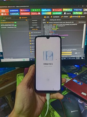

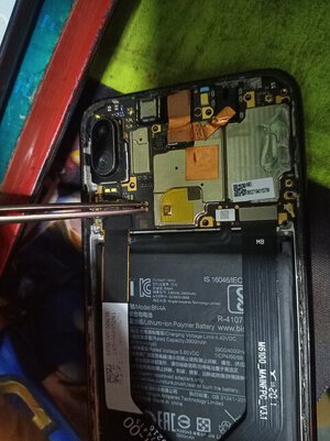

BAKLAS UNIT KASI NEED TP
-OPEN UNLOCKTOOL
-CLICK: Mi
-SEARCH MODEL: Redmi NOTE 7/7s
-Click SECURITY
-SELECT: [EDL] ERASE FRP
-then connect usb cable TESTPOINT
