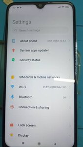

convert china rom to global dahil nais ng may ari na may playstore..
nabili nya pala online super bago..

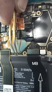

first open the unit for testpoint,with battery.
then open unlocktool for unlock bootloader..

click again read info para ma sure na naka yes na ang unlock bootloader it must be yes,then proceed na tayo sa flashing..
punta na tayo sa MI FLASH,click na yung folder sign then hanapin na yung file na na download then click flash,

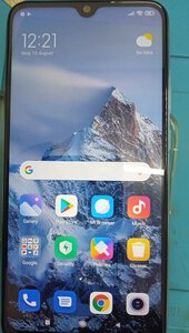

wait till done,medyo matagal flashing at rebooting nya kaya tyaga lang...
finish product...may playstore na
