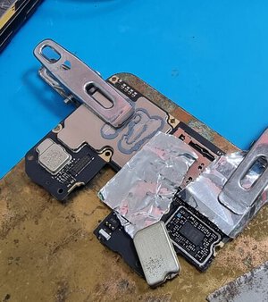

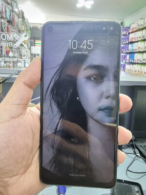

Mervin1993 Registered Joined Oct 4, 2021 Messages 34 Reaction score 78 Points 201 Location 2c 410 thailand st ligtong 3 rosario cavite Nov 10, 2022 #1 Una ko ginawa check battery ok naman sya. Tapos . Tapos ayun may nakita ako sa youtube tanggal plate ginawa ko nag ok naman. Sana makatulong po Attachments Screenshot_20221110-172742_Gallery.jpg 62.5 KB · Views: 148 20221110_174004.jpg 54.1 KB · Views: 151 20221110_174928.jpg 59.2 KB · Views: 151
Anunnaki18 Registered Joined Jan 24, 2019 Messages 757 Reaction score 335 Points 281 Location Manila Nov 10, 2022 #2 tinanggal mo lang un plate lods nag ok na po?
Mervin1993 Registered Joined Oct 4, 2021 Messages 34 Reaction score 78 Points 201 Location 2c 410 thailand st ligtong 3 rosario cavite Nov 11, 2022 #3 opo un lang po gagawin boss
P pascual13 Registered Joined Feb 12, 2022 Messages 43 Reaction score 8 Points 1 Location Angono Rizal Nov 11, 2022 #4 Boss settings ng hot air mo salamat newbie tech
Spy299 Registered Joined Jan 6, 2022 Messages 4 Reaction score 0 Points 1 Nov 13, 2022 #5 Negative SA akin Boss
P pascual13 Registered Joined Feb 12, 2022 Messages 43 Reaction score 8 Points 1 Location Angono Rizal Nov 13, 2022 #6 Spy299 said: Negative SA akin Boss Click to expand... Anu issue ng sayo boss
cyclonelane Registered Joined Jan 26, 2017 Messages 468 Reaction score 3 Points 31 Location Caloocan city Nov 13, 2022 #7 Tanggal plate lang boss, may shorted kaya sa plate nya?
Mervin1993 Registered Joined Oct 4, 2021 Messages 34 Reaction score 78 Points 201 Location 2c 410 thailand st ligtong 3 rosario cavite Nov 14, 2022 #8 pascual13 said: Boss settings ng hot air mo salamat newbie tech Click to expand... QUICK 2008 GAMIT KO BOSS 400 INIT 40 HANGIN PO
