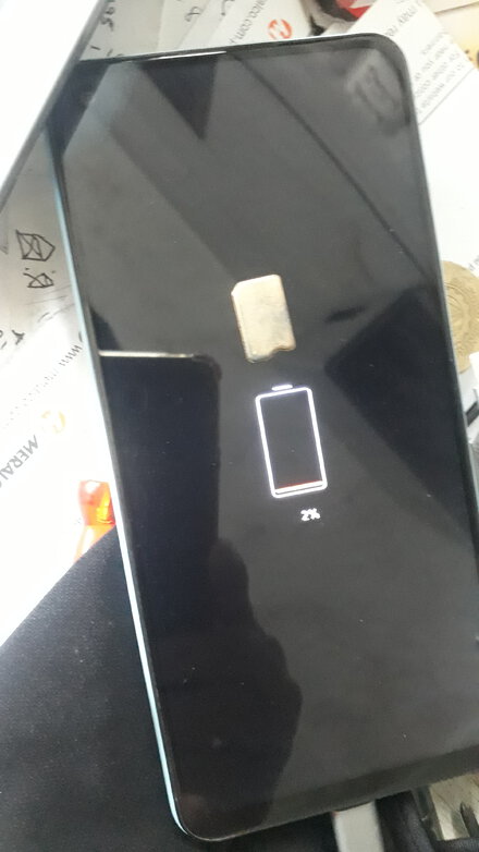

Status:
1.Turn on unit..logo then off agad..
2.Charge unit on and off lang..
3.No recovery mode..pero fastboot mode ok ang unit at di nag off..
Action:
1. Format using software..no luck..
2. Tangal battery..tangal fuse tapos jumper..no luck pa din..change battery same din..
3.Buti may nag post same problem..
4.Tangal lang wifi i.c cover ganoon lang ginawa ko..

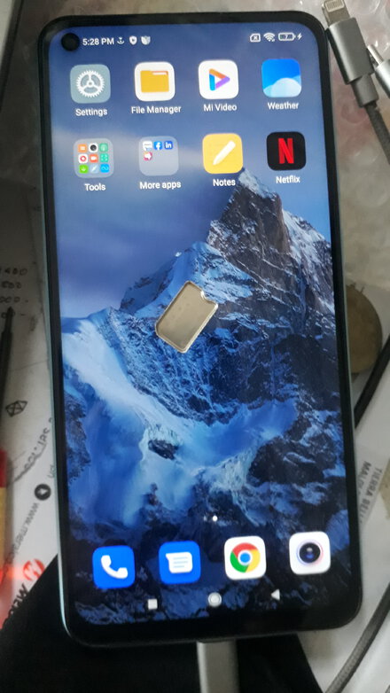

Status: working good na po ang unit..
