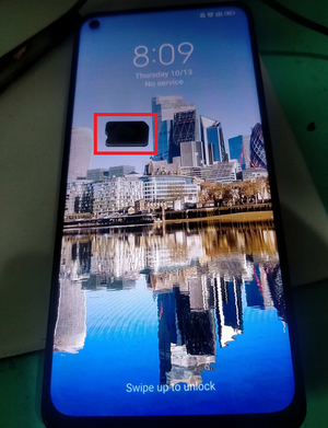

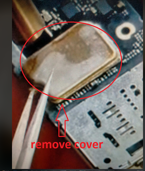

darzkie12 Registered Joined Jul 20, 2019 Messages 164 Reaction score 173 Points 1 Location eastern samar borongan city Dec 8, 2022 #1 history bigla lang daw nag restart taz hindi na tumuloy action 1st baklas unit try ko jumper LK ung parang diode sa battery NO LUCK 2nd hanap google at youtube, di naman nabigo 3rd tanggal takip lang sa my bandang sim slot ayos na. ito pics finish

Mabz Premium Account Joined Jan 21, 2021 Messages 25 Reaction score 16 Points 1 Location Aklan Dec 27, 2022 #4 Pagtqnggal lang ng takip solution boss??
darzkie12 Registered Joined Jul 20, 2019 Messages 164 Reaction score 173 Points 1 Location eastern samar borongan city Dec 27, 2022 #5 Mabz said: Pagtqnggal lang ng takip solution boss?? Click to expand... yes sir
J j4m2_6 Registered Joined Apr 27, 2021 Messages 1,435 Reaction score 2,965 Points 341 Location La Union ™️ ( Region 1 ) Dec 27, 2022 #6 cover lng tinaggal bos or reheat ?
darzkie12 Registered Joined Jul 20, 2019 Messages 164 Reaction score 173 Points 1 Location eastern samar borongan city Dec 28, 2022 #7 Hi-Tech said: cover lng tinaggal bos or reheat ? Click to expand... remove cover lang sir.
