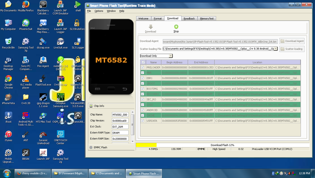

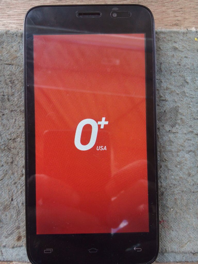

first option:try muna sa hard reset but no luck
2nd option:hanap firmware my nakita ako
ito ang firmware tested by me...
O+ 8.38 firmware

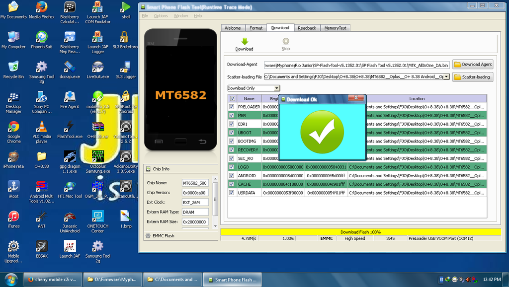

open SPT select the firmware then hit download

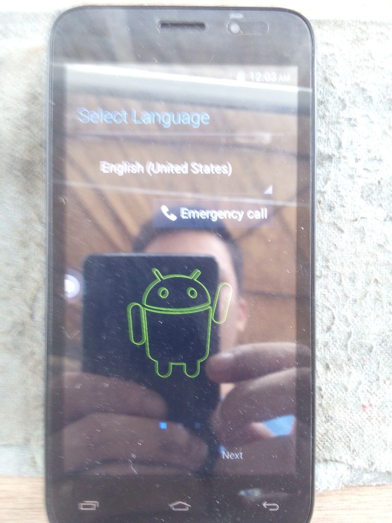

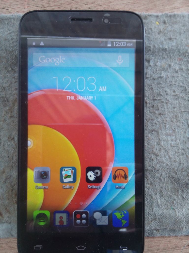

ito po Done na...:D:D:D
thanks for viewing!!
