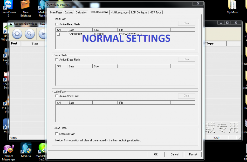

HOW TO FIX ANY ERROR RESERACH DOWNLOAD FLASHING
SOLUTION HERE

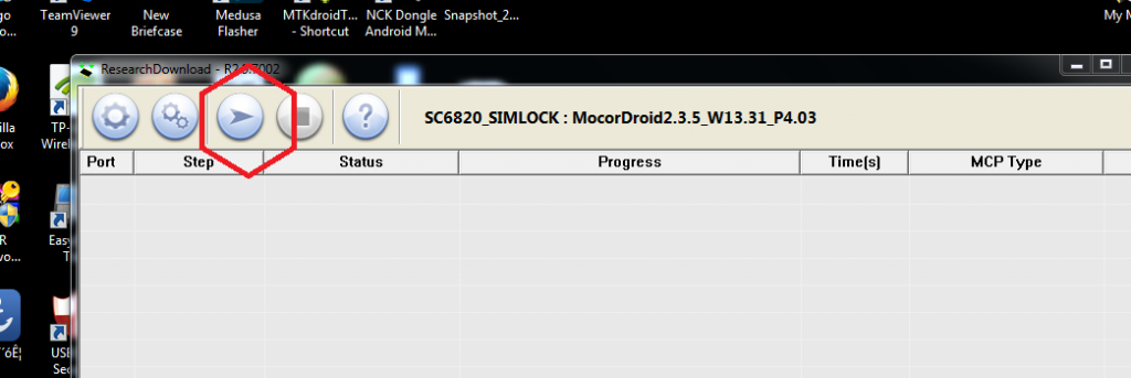

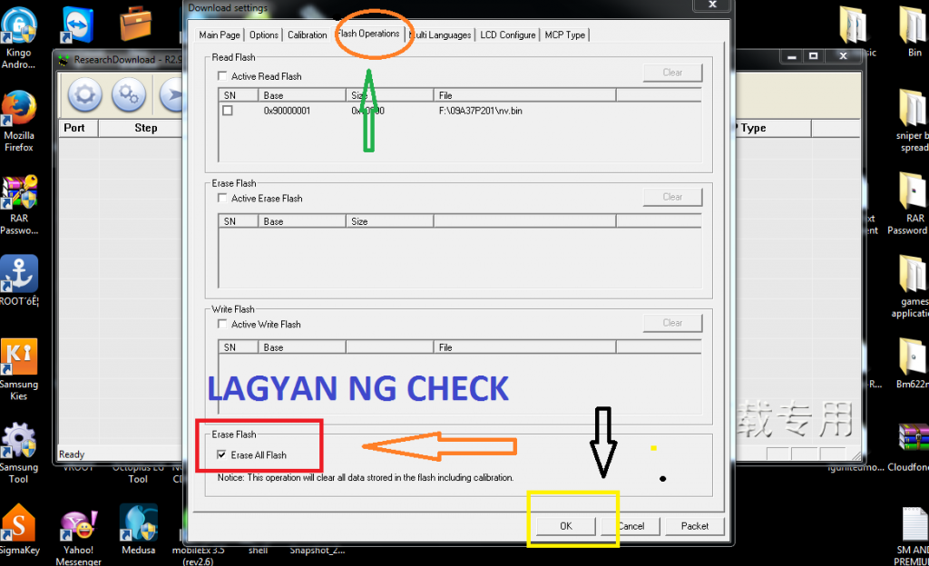

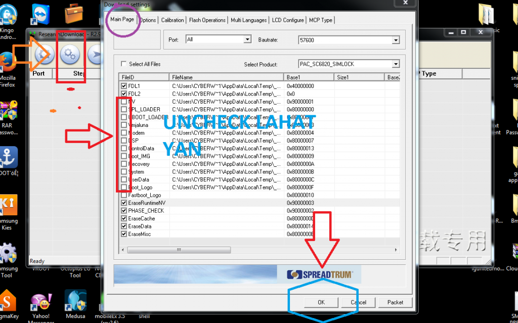

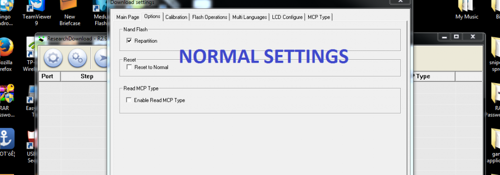

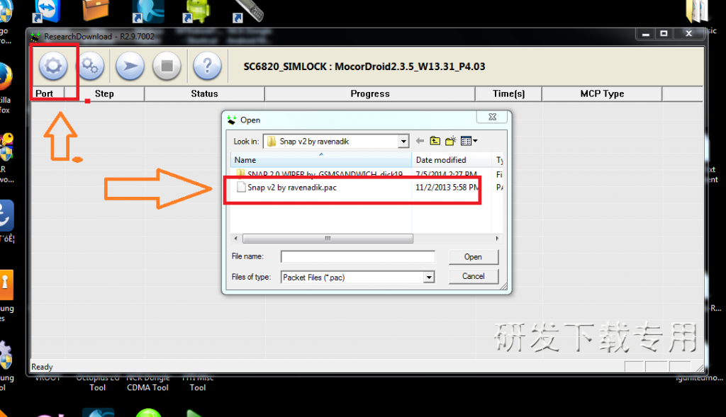

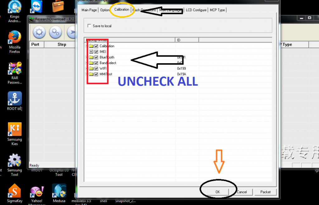

FIRST STEP : FLASHING ERASE

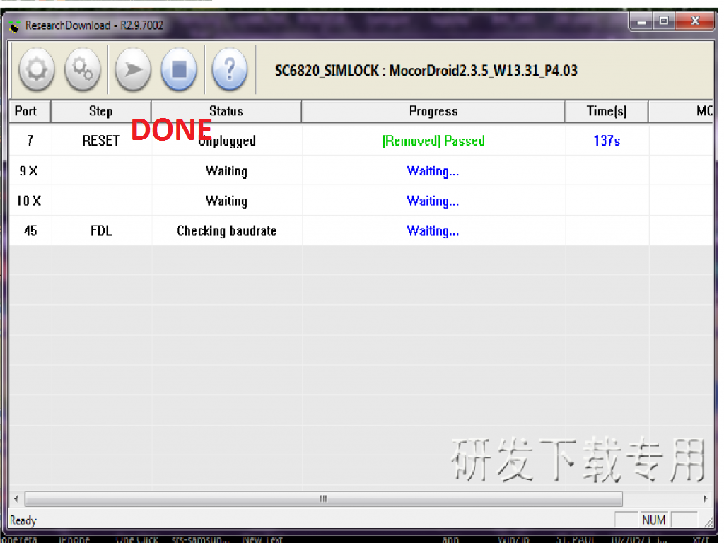

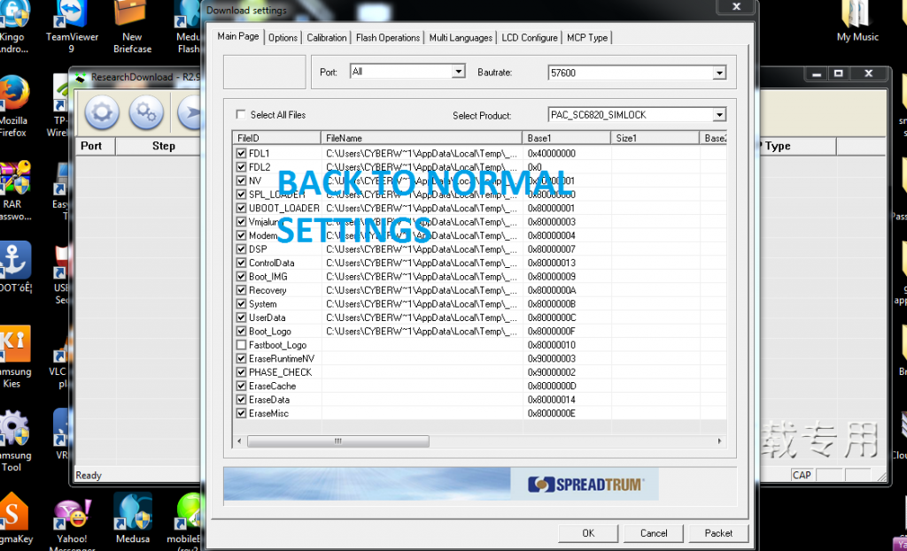

2nd Step: FULL flashing/ Normal FLASH
NOTE:
AFTER FLASHING ERASE PATAY PO ANG UNIT...MAHIRAP IPACONECT : ITO NAMAN TRIKZ REMOVE BATTERY+ HOLD VOLUME BUTTON + INSERT USB CABLE + INSERT BATTERY ... AYAN KUSANG MAG CONECT NA SI PHONE
NOTE: IF ERROR FLASHING ITO SUNDAN
PAKIBASA NALANG NG MABUTI ANG MGA NASA PICTURE.. THANK YOU AND GOOD LUCK :D
