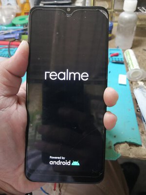

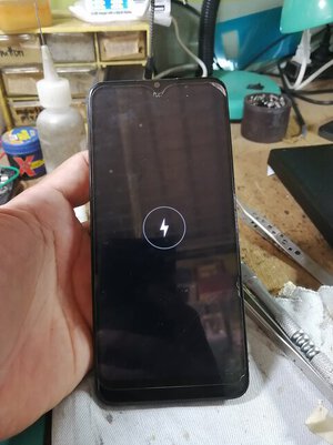

Bigay ng costumer ko naka hang na sa Logo tapos ng tanggalin ko battery at charge naka hang parin. Need ma format using Hydra Tool.

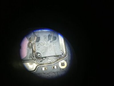

Baklas si Unit at solder ang ISP pinout.

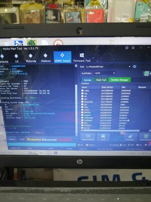

Open si Hydra Main Tool
No battery connected
Sa Port dapat my madetect na PhysicalDrive1
Press EMMC INFO
Goto Partition Manager and click Listing Partions
Kailangan ang naka check lang misc
Click Erase/Wipe
Wait Until Done.

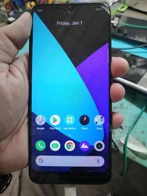

Assemble ulit si Unit at kapag may FRP
*#813# lang sa emergency call at ok na.
