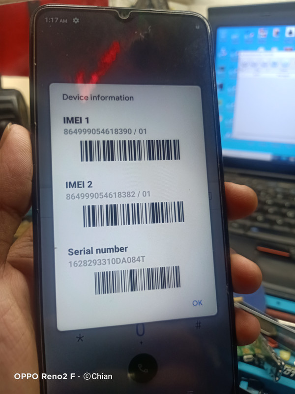

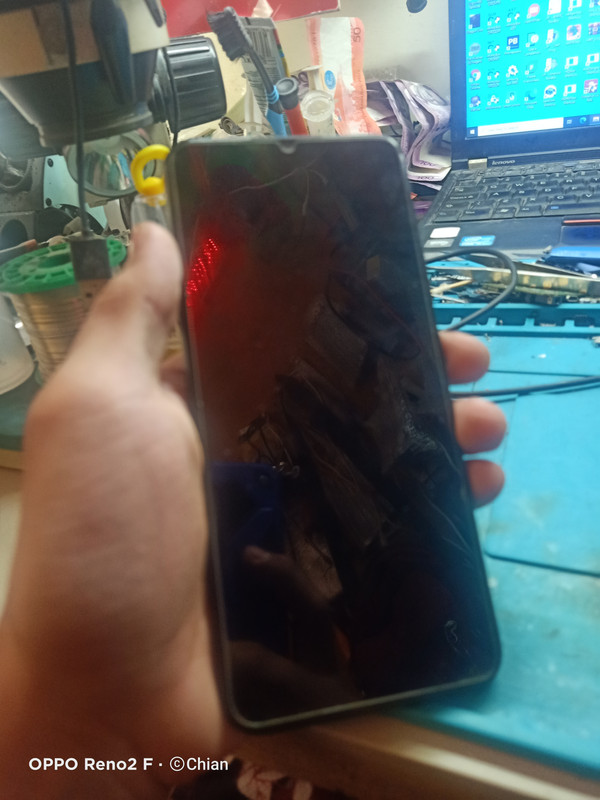

Hello po sa inyong lahat. Today may tanggap po akong unit c21y daw bigla nalang daw namatay
So tinry ko muna pa detect sa pc kung magdedetect at ayun nagdetect nga kaya naisip ko try muna program at hindi naman ako nabigo.

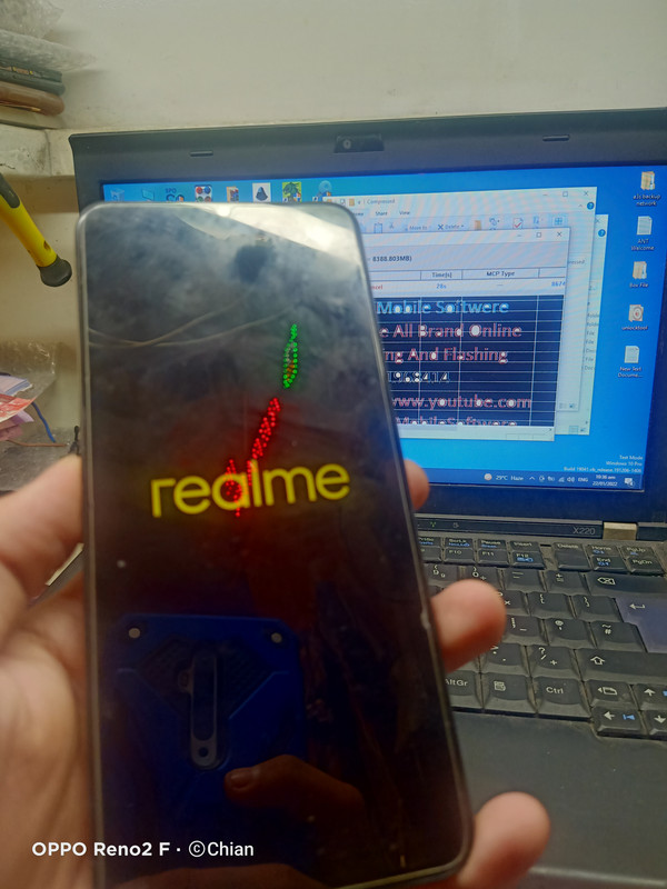

Open SPD research tool and click 'RsearchDownload and click Settings sign at i load ang frimware.
Here's the firmware i used
https://drive.google.com/file/d/1PF-6Mh6rENoTkxkM1lhAw-DbHGnIjWkl/view
Pass: changsm1994
After load click Play sigb. Hold volume up and down and insert usb cable and wait until it done

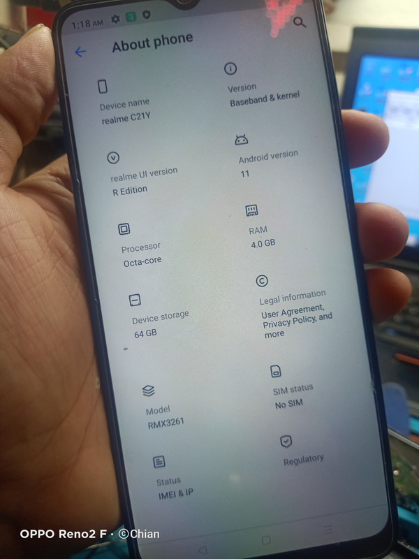

At heto naman po ang aking proof.
