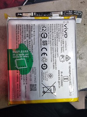

Mervin1993 Registered Joined Oct 4, 2021 Messages 34 Reaction score 78 Points 201 Location 2c 410 thailand st ligtong 3 rosario cavite Feb 9, 2023 #1 May tanggap ako s1 pro po. Logo lang check ko battery. 4.2 na sya leak na. Tinest ko ayusin resistor sa battery ganun padin Ginawa ko palit battery ok na sya. Attachments 20230209_121853.jpg 70.1 KB · Views: 28 20230209_114241.jpg 91.4 KB · Views: 27
J j4m2_6 Registered Joined Apr 27, 2021 Messages 1,435 Reaction score 2,969 Points 341 Location La Union ™️ ( Region 1 ) Feb 9, 2023 #2 Mervin1993 said: May tanggap ako s1 pro po. Logo lang check ko battery. 4.2 na sya leak na. Tinest ko ayusin resistor sa battery ganun padin Ginawa ko palit battery ok na sya. Click to expand... Pede nmn remove lng fuse or jumper no ned palitan sa batt sir ? much better ok n rin pinalitan bago...
Mervin1993 Registered Joined Oct 4, 2021 Messages 34 Reaction score 78 Points 201 Location 2c 410 thailand st ligtong 3 rosario cavite Feb 10, 2023 #3 Hi-Tech said: Pede nmn remove lng fuse or jumper no ned palitan sa batt sir ? much better ok n rin pinalitan bago... Click to expand... Ginawa ko na un boss. Kasi dead na talaga battery. Kaya pinalitan ko na po boss
