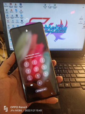

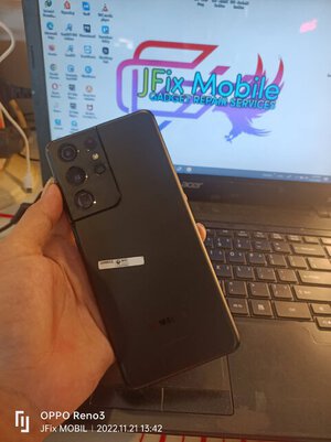

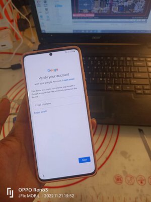

SAMSUNG S21 ULTRA O SM-998B/DS NAKALIMUTAN NI CUSTOMER ANG PASSWORD AT FRP DI NA DAW NYA MATANDAAN..

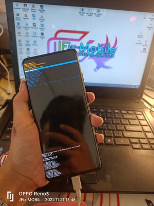

ITO LANG GINAWA KO MGA DOL.... KARAMIHAN NAHIHIRAPAN MAG PA LABAS NG RECOVERY MODE KAHIT AKO PIRO
DITO LANG NAGING MADALI MAPALABAS

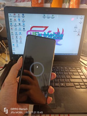

1.LONG PRESS POWER OFF AND VOLUME DOWN NG SABAY PARA MAG POWER OFF AT SABAY SAKSAK MO
AGAD ANG CHARGER PARA DI TUMOLOY SA PAG RESTART.. (HARD RESET GAGAWIN PARA MABILIS LUMABAS)
2. KAPAG NA POWER OFF NA HINDI MAG RESTART TANGGALIN MO CHARGER TAS POWER ON 1SECOND SALPAK AGAD
CHARGER AT SABAY VOLUME UP AT BITAWAN MUNA ANG POWER PAG LUMABAS ANG LOGO(KARAMIHAN RITO NAHIHIRAPAN MAPALABAS
ANG RECOVERY MODE... HINTAYIN MO LANG PAG NAG RESET KANA

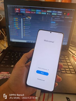

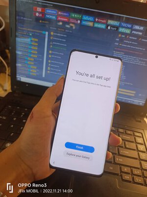

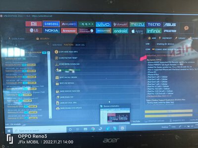

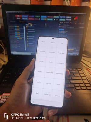

3.PAG NA RESET AT MAY FRP BYPASS DIAL *#0*# CONNECT SA LOPTOP OR PC AT (OPEN UNLOCK TOOLS ) CLICK
1, SAMSUNG
2, FUNCTION
3, [COM] REMOVE FRP
4, START (WAITING HANGGANG MATAPOS
(KAHIT NAPO WALANG MODEL NA NILAGAY MAG RURUN PARIN PO YUN)
