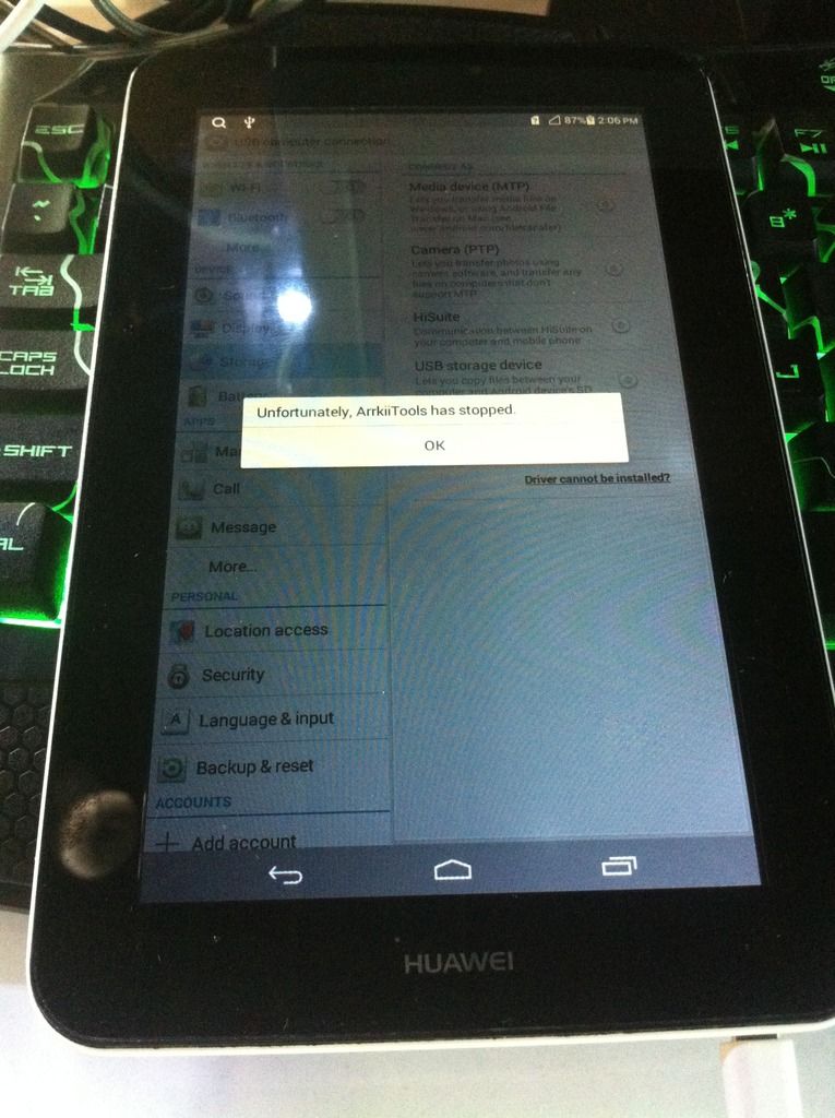

MODEL: HUAWEI S7-721U MediaPad 7 Youth 2
PROBLEM: UNFORTUNATELY ARKIITOOLS HAS STOPPED

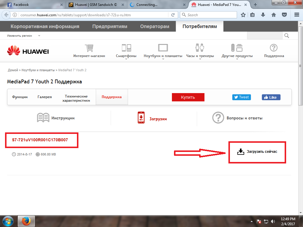

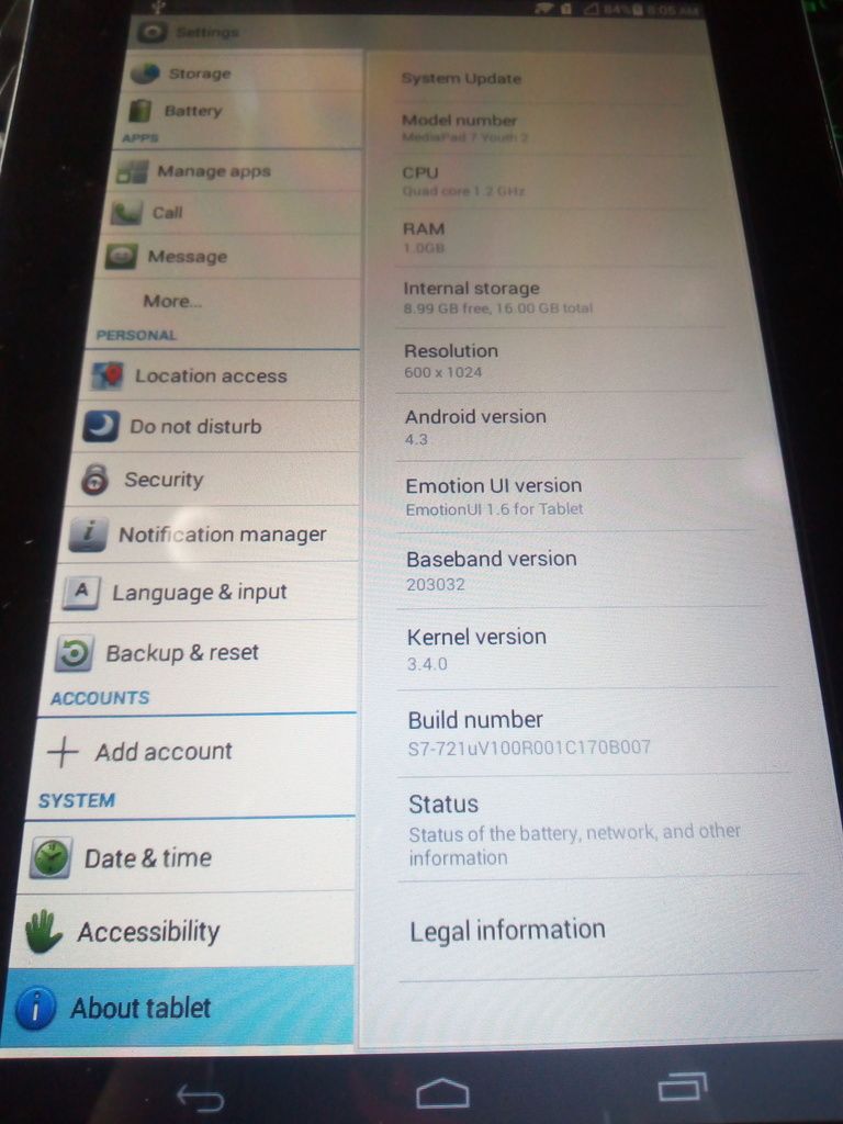

TESTED FIRMWARE HERE: HUAWEI S7-721U MediaPad 7 Youth 2

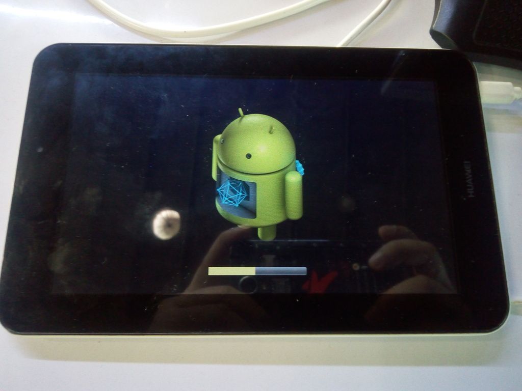

4) PRESS VOLUME DOWN +POWER KEY automatically into SD card upgrade

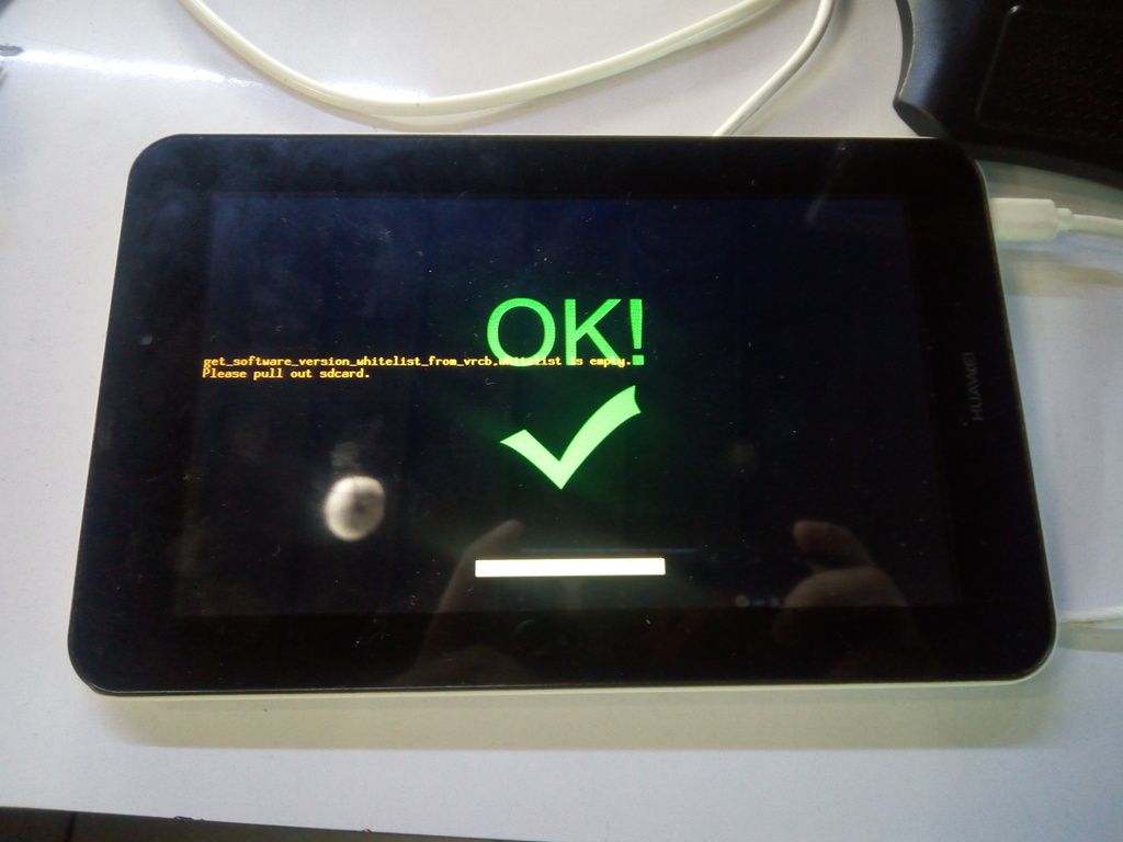

5) When the machine with a screen, the normal upgrade process,
6) When the machine with a screen, the upgrade is successful, the screen displays "OK" word.
After the upgrade is complete, remove the SD card machine will automatically restart.

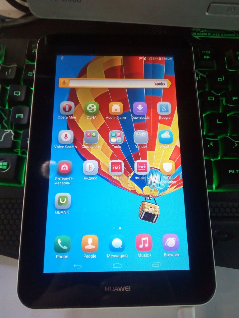

DONE...
