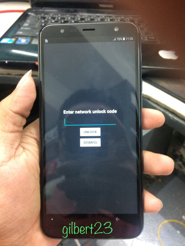

Samsung J415FN History;Humihingi unlock code galing us
Proceed agad ako unlock

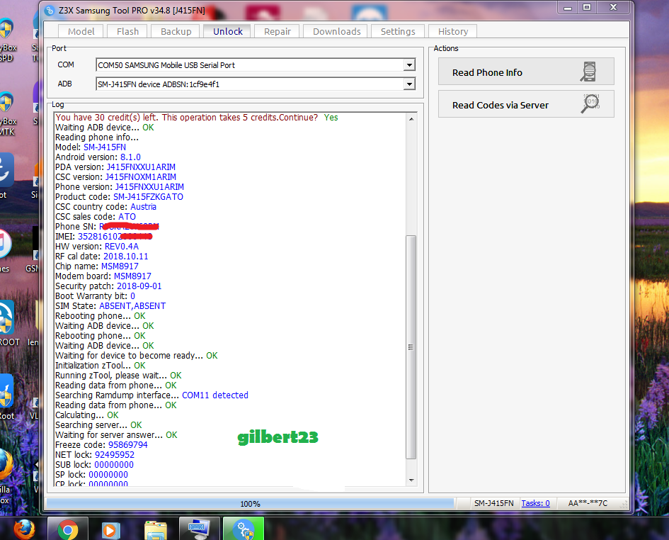

Procedure;z3x pro v34.8 latest
Open Phone setting tap build number 3x and open developer
Off oem check debug dial *#0808# select DM+ACM+ADB salpak phone
thick read codes via server,kitang kita naman sa picture​
wait until done

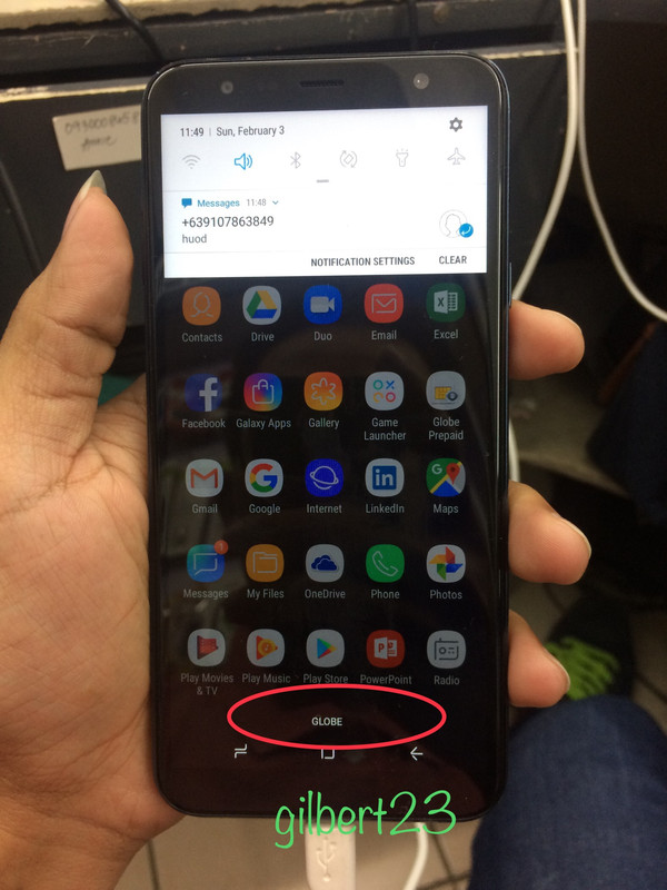

Ayan na po 1300 na:))​
