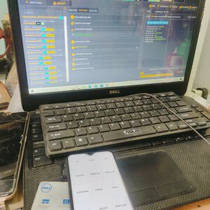

*open unlocktool
*select Samsung tab
*Click remove FRP (2022)
*Open device go to emergency call
*Type *#0*#
* Salpak unit. . sa computer/laptop

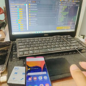

Ayun. .
Ayun smile na

*open unlocktool
*select Samsung tab
*Type *#0*#
Ayun. .
Ayun smile na
