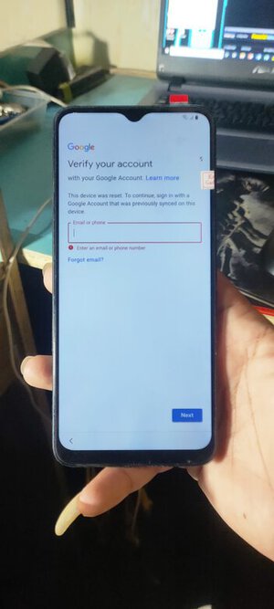

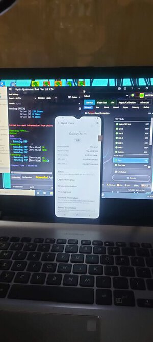

Samsung A02s frp remove via hydra qualcom tool (test point)
Step:
Baklas si unit

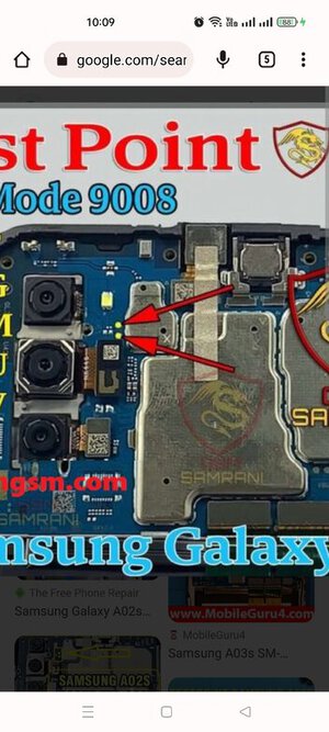

Eject battery ready for the test point
Open hydra qualcom tool
Brand: Auto
Model: Auto
Click boot info
TP plug USB cable
Pag na ditek na bitiwan remove tp
After boot info
Choose factory reset protection (frp)
Flash mode
Select auto
Click execute and wait until doneScreenshot_2022-11-05-22-09-17-51_40deb401b9ffe8e1df2f1cc5ba480b12.jpgIMG20221105090112.jpgIMG20221105085304.jpg
tested boss salamat:)
