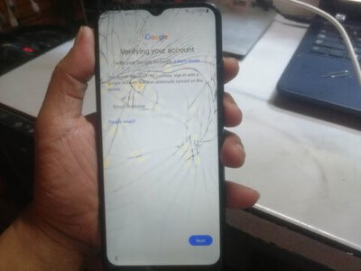

samsung A03 (A035f) dala ni tumer naka frp na.

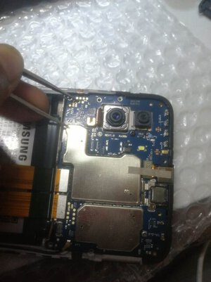

remove back cover for testpoint.

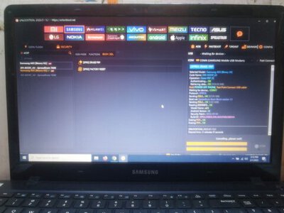

open unlock tool
click samsung tab
search A035F
select Samsung A03 [Binary U1]spd
click [SPRD] ERASE FRP
TANGGAL BATTERY
connect tp then saksak usb cable sa phone.

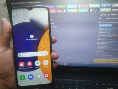

done.

salamat dito sa post mo,, just tested it. First time ko ginawa or ginaya ung step, ngayun mismo bago ako magcomment. tested siya, success,.. malinaw ang instruction. keep up.
