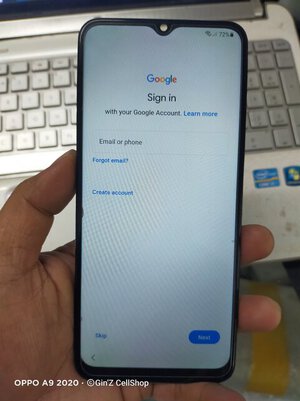

SM-A037F dinala nang tropa na dead dw sa unlock tool fix via UFI (no detection na sa PC)

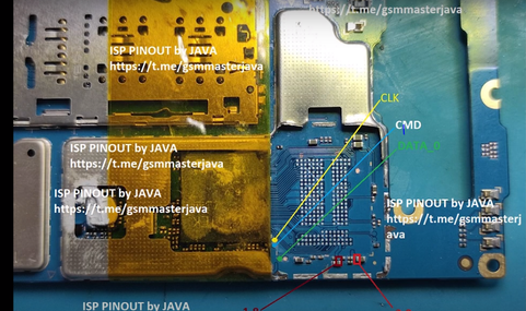

1st step hanap isp pinout sa google

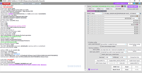

2nd step
connect to UFI JTAG and click identify

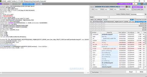

3rd step go to FACTORY IMAGE and select samsung as MODEL then load PIT file and BL (uncheck ibang resources nang BL ang ititira preloader)
and click write

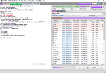

4th step go to USERPART and CLICK SPECIAL TASK then REMOVE FRP (para d kna mag bypass just incase may frp pa pla)

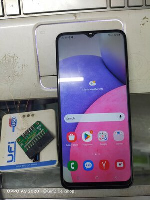

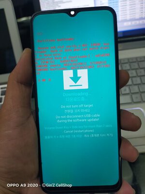

5th step remove na ISP pinout then power on at mag download mode na yan
6th step flash nyo nlng sa kahit anung gusto nyong flasher (z3x odin octoplus etc.), sakin sa eft ko sya naiflash
FIRMWARE: https://www.mediafire.com/file/chgowcko7wygi8v/Samfw.com_SM-A037F_CAC_A037FXXS2CWA3_fac.zip/file
Sana mka tulong
