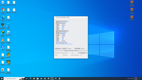

frp bypass samsung a03s (A037F)
Steps
power off unit
open MTKSecBootDisable
hold VOL -+
may lalabas na ganto
Waiting for preloader usb device... ok
BootMode : BootLoader[COM16]
Sync with bootrom started...
● Chipset MT6765
● Identifier Helio P35
● Code cervino
● Hw Sub 8A00
● HW Ver CA00
● SW Ver 0000
Switch preloader to bootrom...done!
Waiting for bootrom usb device... ok
BootMode : BootRom[COM17]
● Chipset MT6765
● Code cervino
● Hw Sub 8A00
● HW Ver CA00
● SW Ver 0000
● SecCFG SBC+SDA
Payload response : 0xa1a2a3a4
MTK Secure Boot Bypasss success!
now you can use SP Flash Tool or any MTK Tool
open SP Flash Tool
sundan ang nasa picture
after malagay lahat ng kailangan hit START
and enjoy

Pano po kung ayaw pumasok sa bootrom? Eto po logs nya
BootMode : BootLoader[COM4]
● Chipset MT6765
● Code cervino
● Hw Sub 8A00
● HW Ver CA00
● SW Ver 0000
pagkatapos nyan pumapasok yung CP sa ODIN mode, hindi sa bootrom.
● Chipset MT6765
● Code cervino
● Hw Sub 8A00
● HW Ver CA00
● SW Ver 0000
gamitan mo testpoint
Kahit testpoint sir ayaw parin. Sinubukan ko sa chimera tool ayaw parin pumasok sa bootrom. Preloader lang tapos direcho sa ODIN. Good naman volume up and down.
