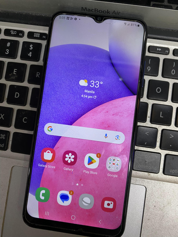

ACTION TAKEN:

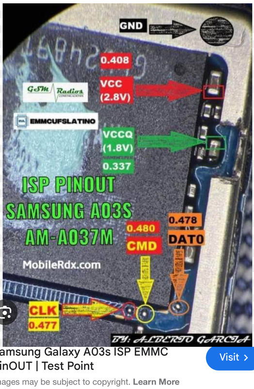

Connect ISP PINOUT
CLK,DAT0,CMD at GRND
Remove battery.
Insert Box Cable

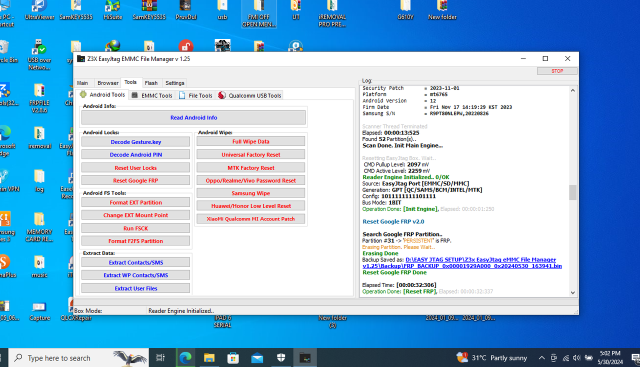

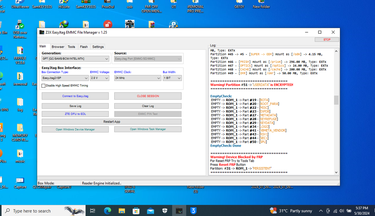

Open Easy Jtag EMMC File Manager
Insert Phone usb cable
Go To Main
Click Connect To Easy Jtag
Go To Tools
Click Reset Google Frp
Done.
