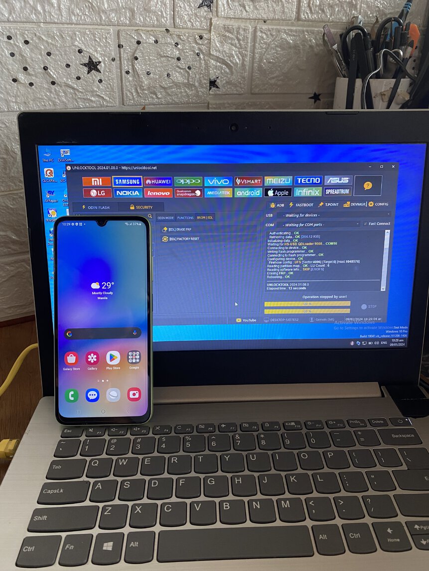

1. open unlocktool
2. select A05s
3. connect EDL wire and press volume up 15 times
4. remove EDL wire and connect the normal wire, after u connect the normal wire, the COM port will be connected.
salamat idol tested!:p

pinadali ni unlock tool ang pag testpoint. thanks for sharing boss.
