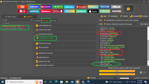

Bypass na natin using UnlockTool

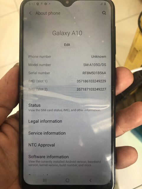

Mapapansin nyo A10s ang nakaselect, success naman kita sa screen shot SM-A105G/DS

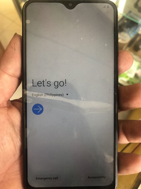

Finish Product....
Done!!!
