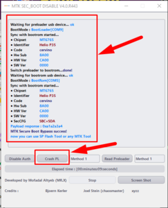

* Turn OFF Phone
* Run MTKSecBootDisable See Pic Bellow
* Once Ganyan Lumabas ( Picture sa Taas )

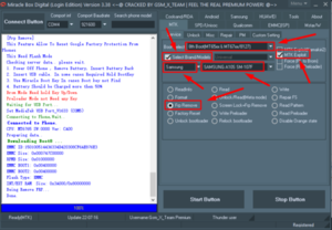

* Open mo ALL MTK FRP Remove Tool ( Sa akin is Miracle Paid Crack )
* Sak-sak USB Cord ( No Need Press Volume + and - )
* Wait Until Done
