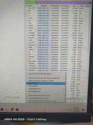

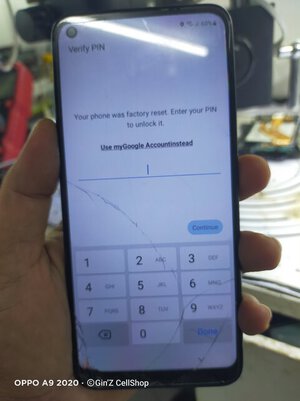

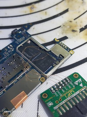

SAMSUNG A11 FRP PROBLEM, GALING NA SA TROPANG TECH MATIGAS DW LALO NA AT DI GUMAGANA ANG *#0*# SA EMERGENCY CALL, DI DIN DAW KINAYA SA MANUAL REMOVE KAYA REKTA NA AKO SA ISP METHOD :cool:
PROCEDURE

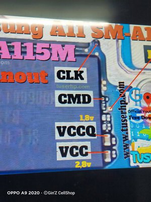

1.) SOLDER ISP PINOUT IN MOTHERBOARD

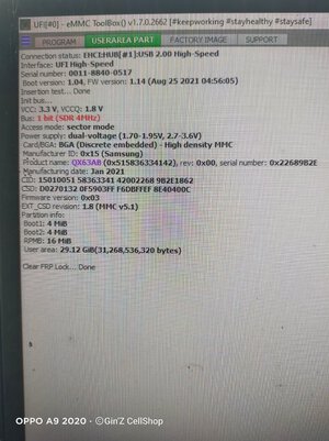

2.) CONNECT UFI BOX TO PC AND RUN SOFTWARE

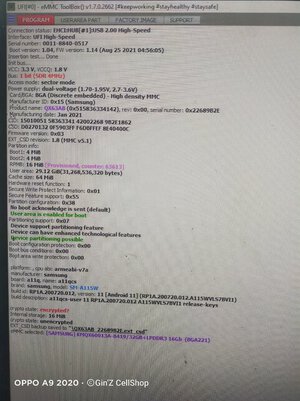

3.) CHECK BOX UNDER IDENTIFY BUTTON AND CLICK IDENTIFY
3.) GO TO USERAREA PART TAB AND CLICK SPECIAL TASK
4.) SELECK CLEAR FRP LOCK AND ENJOY:cool:
IMG20221220203257.jpgIMG20221220204111.jpgIMG20221220204103.jpgIMG20221220204356.jpgIMG20221220204400.jpgIMG20221220204607.jpgIMG20221220204632.jpgIMG20221220205401.jpg

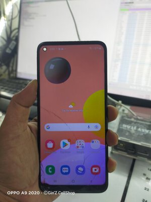

DONE PO :cool:
