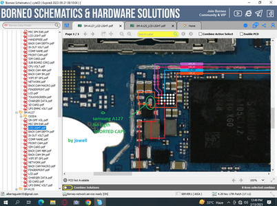

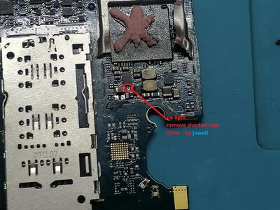

samsung A127 no ligth dahil na basa unit
ACTION TAKEN
1,open the unit cleaning using lucker tinner no luck
2, try new lcd no lock parin
3, diode test and tracing gamit ang borneo schematics & hardware sulotion done
shorted capacitor
see the picture

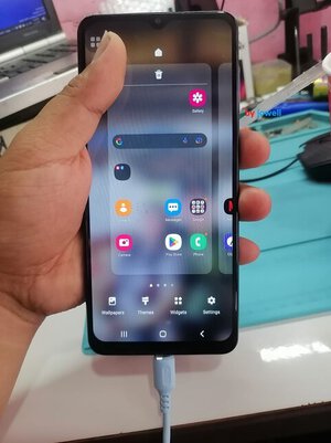

DONE.....
