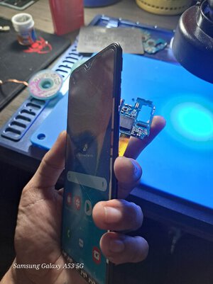

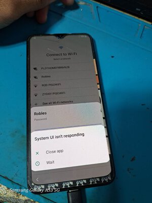

Issue nang phone Hang on Logo minsan mag menu system Ui Error lumalabas then restart ulit
Naka ilang Flash na same issue parin

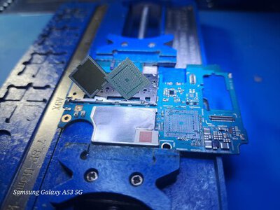

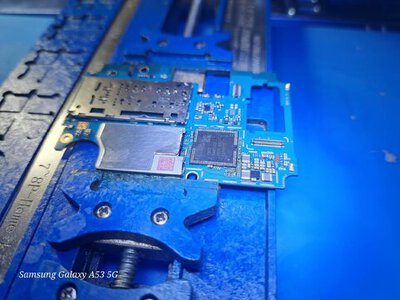

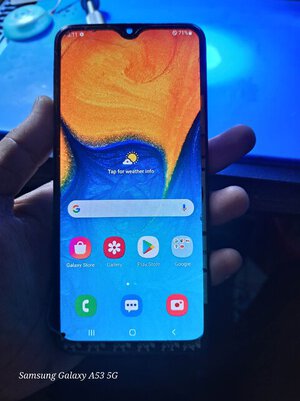

Solution Reball RAM at CPU
Tools Needed
-Quick 2008
-Mechanic Solder Paste
-Cpu exynos 7884 /Ram exynos 7884 Stencil
-Sexy Blade
-Amtech Flux
-To remove Ram and Cpu HEAT 380 AIR 60
-To put it back Ram and Cpu Heat 370 AIR 40
