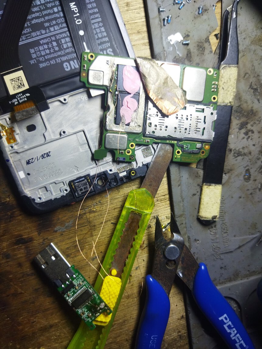

Samsung A20s FRP DONE
-eMMC ISP & Connect Device

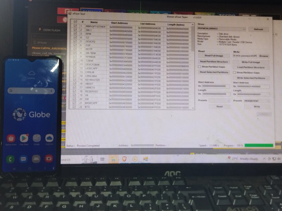

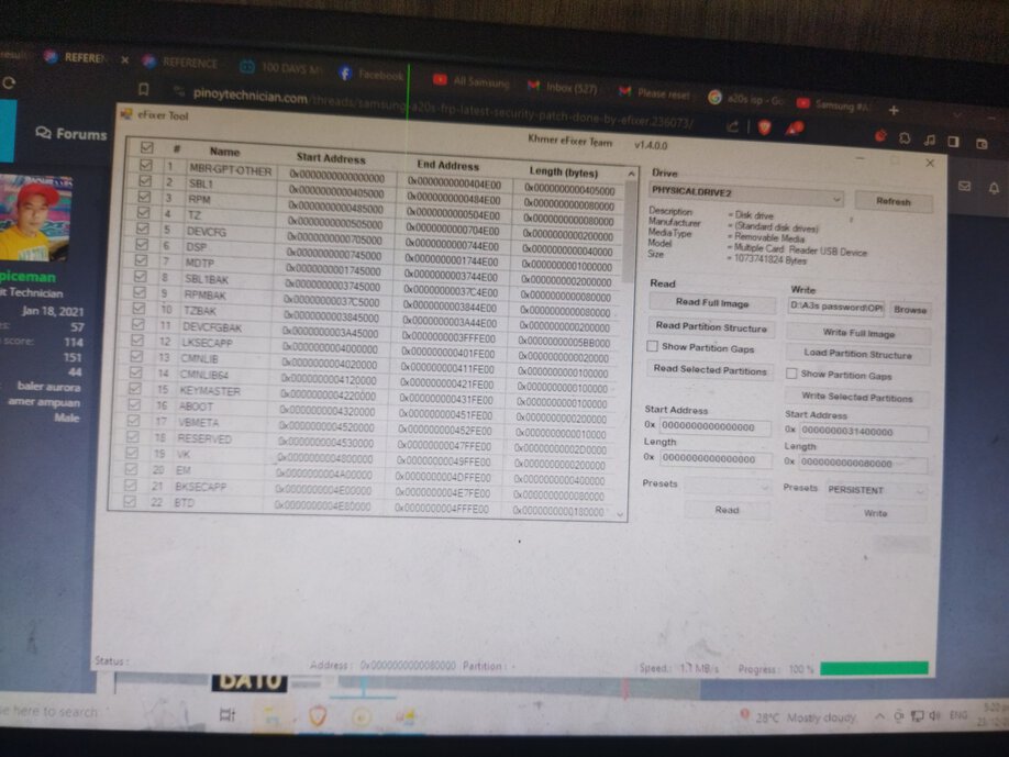

-Open eFixer Tool.exe https://www.mediafire.com/file/seqtzttwvvs03kf/OPPO_A3s_%26_A5_2020_%26_A7_eFixer_Tool.rar/file
-Browse BIN File Credit to owner
-Click Load Partition Structure
-Then Click Presest click v sign then select (PRESESTENT) the last,, hits WRITE.
-Done Process Completed
DONE!!
