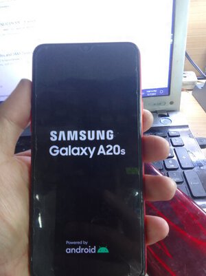

1.try lcd 1st pero negative

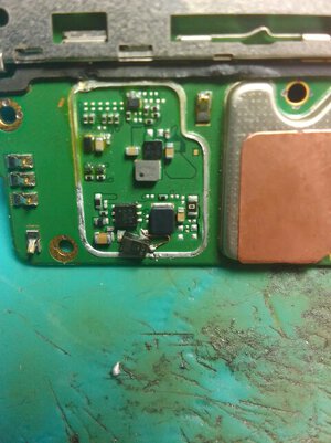

2.check light section
3.check voltages okie nmn check coil okie, last replace this diode done na
( note )
Kumuha lng Ng diode na kaparehas sa function sa papalitan
