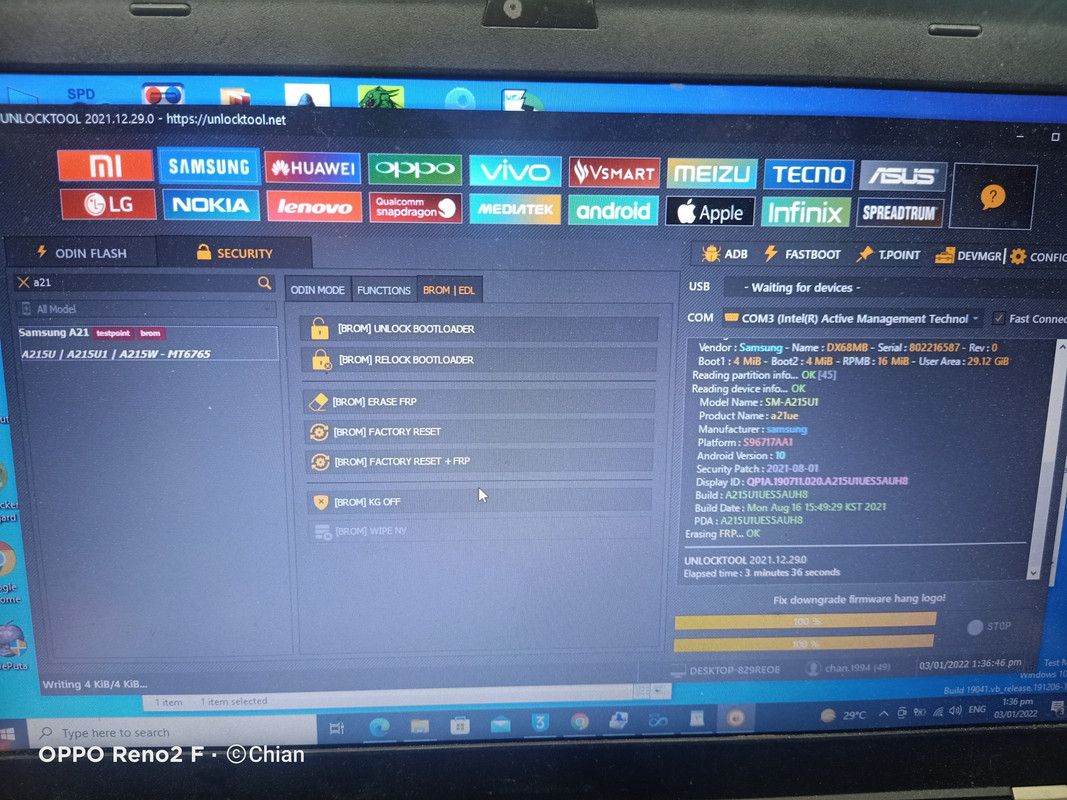

Process na po tayo agad tutal hindi naman din po need buksan unit.
1st. Open unlock tool
2nd. Select Brand 'Samsung'
3rd. Search model (A215U)
4th. Click [BROM] ERASE FRP
5th. Hold volume up and down then insert usb cable and wait until it done.

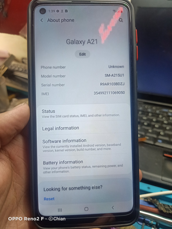

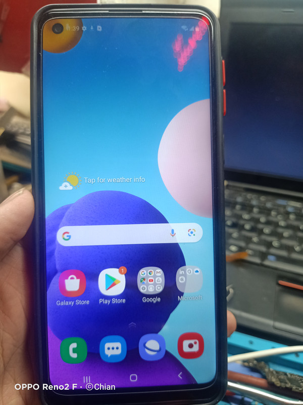

Heto naman po succesful process ko.
