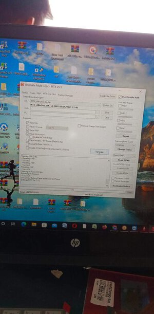

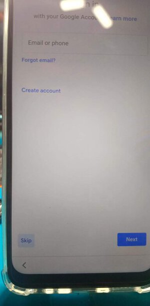

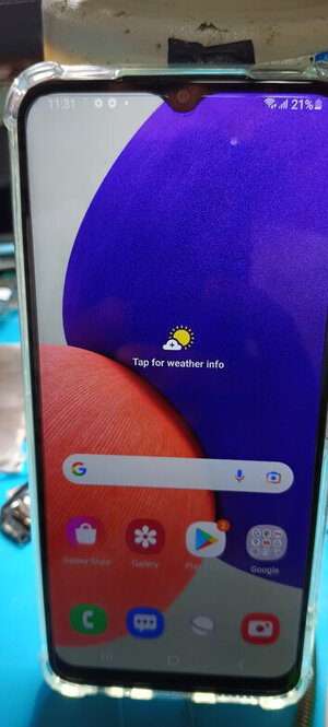

samsung a22 5g remove google account via umt mtk v5.1
1. open umt mtk 5.1 then select MTK ONE CLICK
2. Check reset FRP
3. power off the phone
4. press v+ and v- then salpak usb
5. hintayin nlng matapos
2. Check reset FRP
sir anong android version ng a22? version 13 ba
