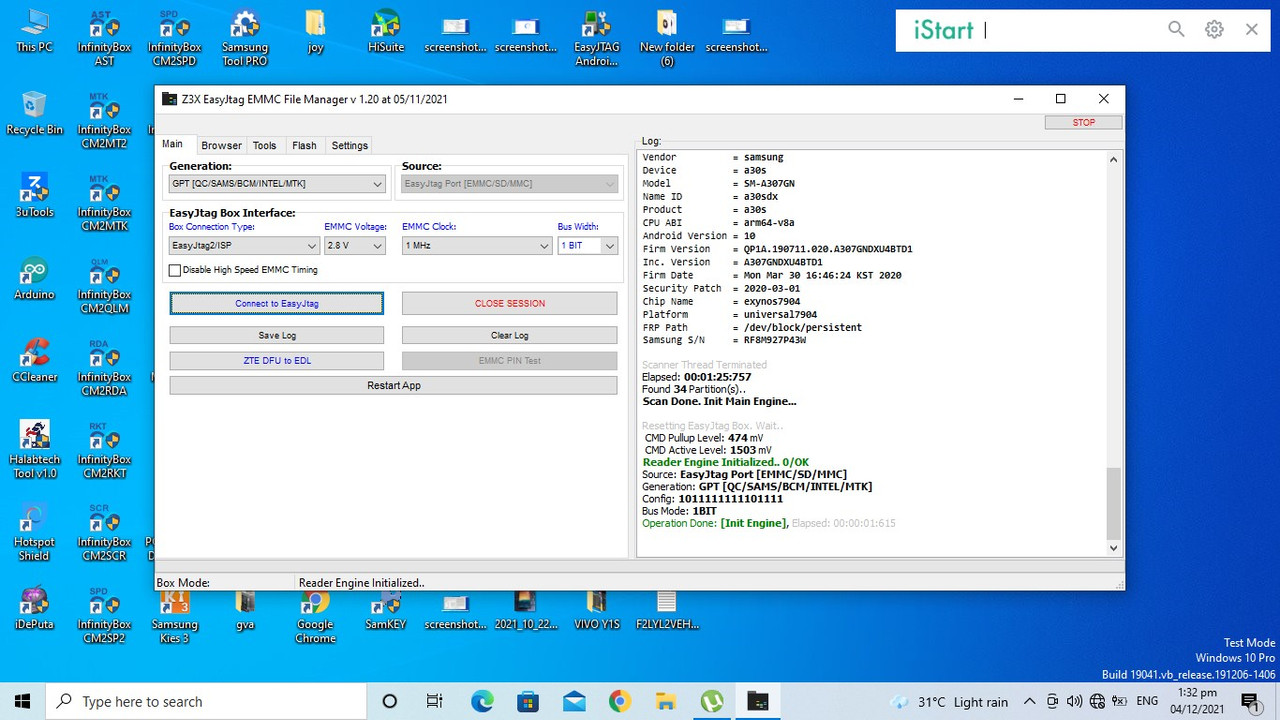

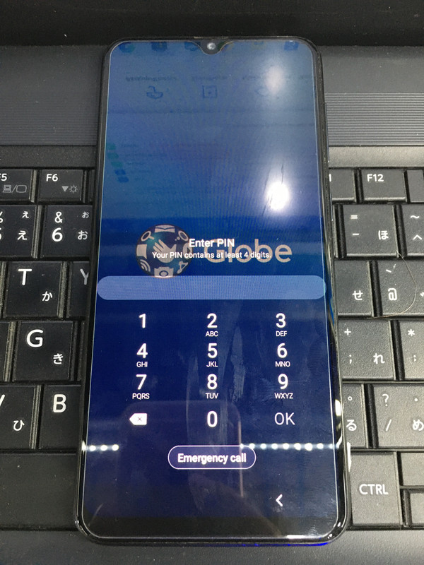

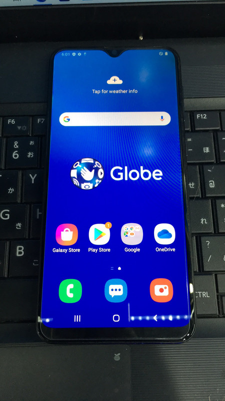

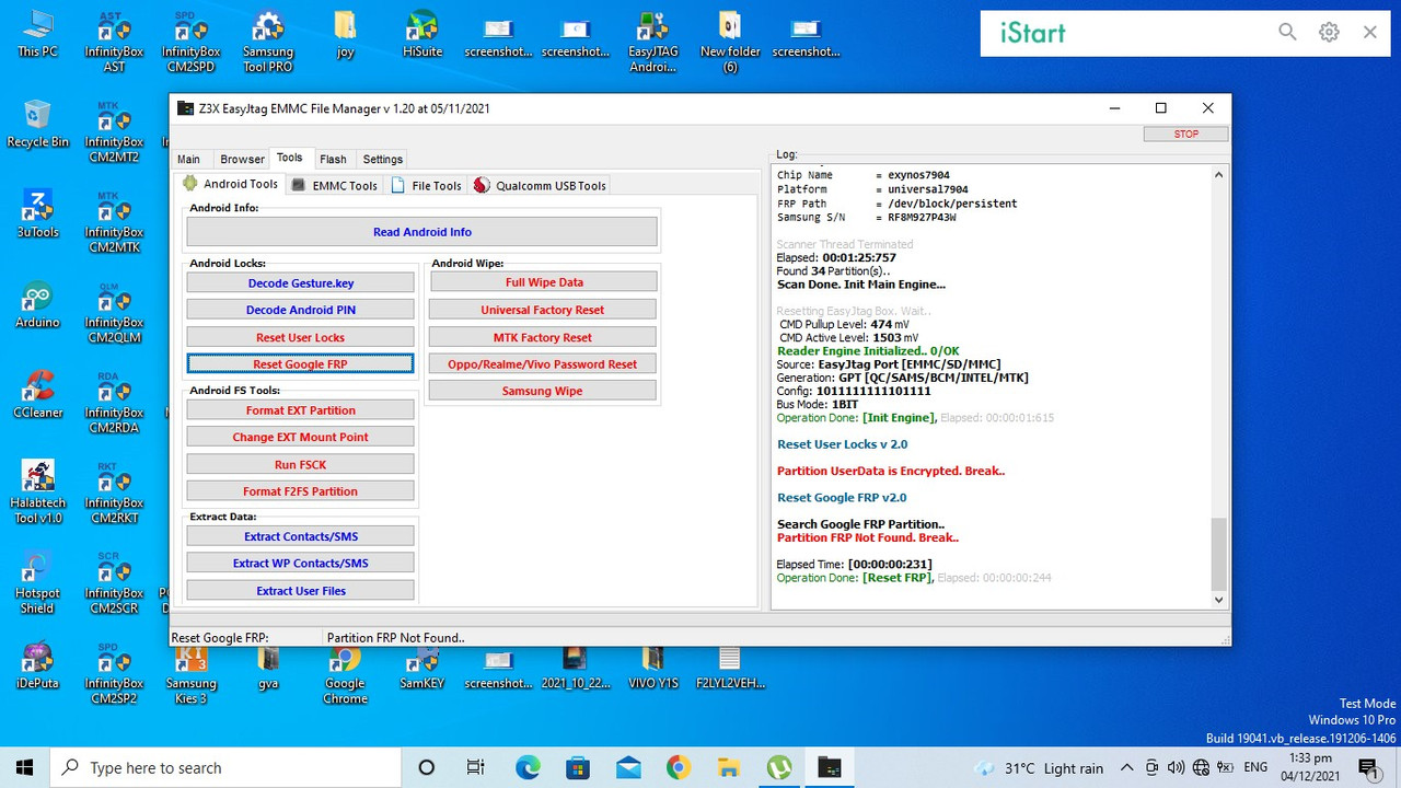

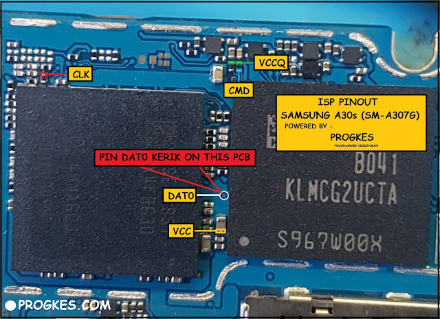

J joystikz Premium Account Joined Dec 4, 2014 Messages 155 Reaction score 148 Points 1 Location Davao City Dec 11, 2021 #1 ACTION TAKEN: 1. Hard reset para matanggal ang password. 2. Sa FRP buksan ang unit para sa isp pinout. Connect CLK,CMD,DAT0, VCC, VCCQ at GROUND sa pinout board nalang ang ikabet sa ISP Connect ISP sa box Open EASY JTAG EMMC FILE MANAGER Click CONNECT TO EASY JTAG Go to TOOLS RESET GOOGLE FRP DONE.
