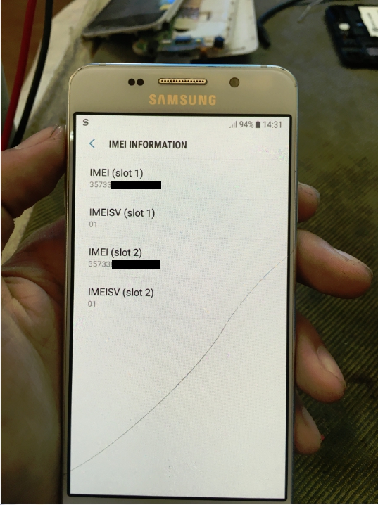

UNIT: SAMSUNG A310F/ A3 2016
ISSUE: FRP LOCK
SOLUTION:
WALA PA KONG Z3X
TRY KO VIA ODIN
WATCH NYO TOH
FULL PROCEDURE A310F FRP BYPASS
ANJAN DIN UNG "COMBI FILE" NA NEED NYONG IDL (382MB YAN)
ETO DIRECT LINK NG FILE
NO PASSWORD
PAREHO LANG YAN NUNG NASA VIDEO
DL DIN KAYO NG FLASHFILE FOR A3 2016
ETO KINUHA KO A310F/A3 2016 NOUGAT
Lista ko na din ginawa ko: (if nd mo ma view ung video)

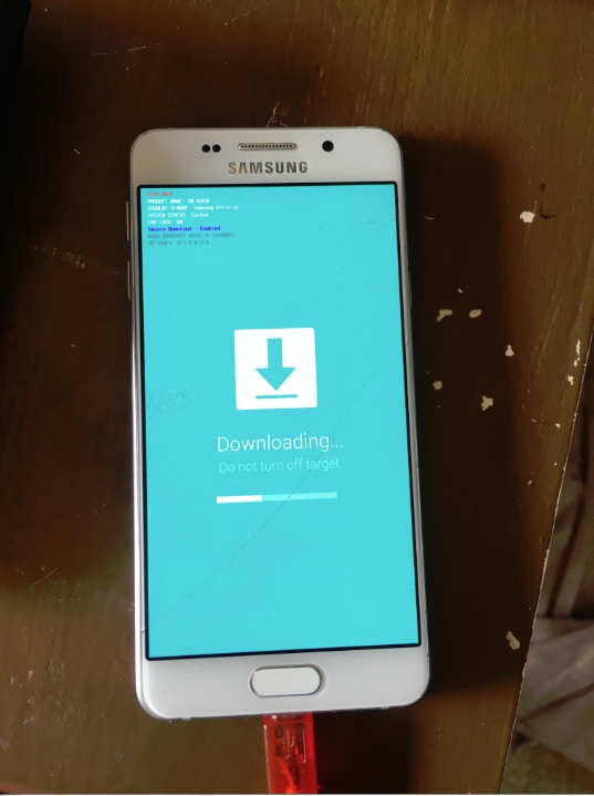

DOWNLOAD MODE YOUR UNIT
OPEN ODIN
CLICK AP (LAGAY MO JAN UNG COMBI FILE NA DINOWNLOAD MO)
PAG TPOS NA

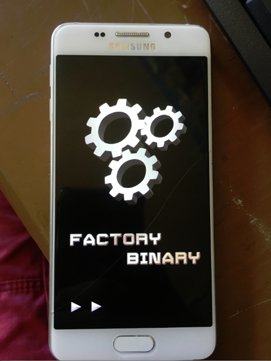

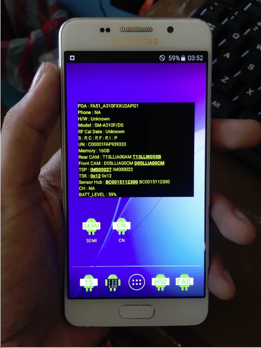

ON UNIT
GANITO LALABAS

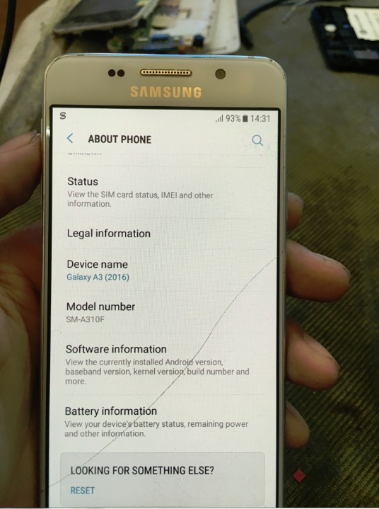

GO SA SETTINGS
GO TO DEVELOPER OPTION (KUNG TECH KA ALAM MO PALABASIN YAN )
ON MO USB DEBUGGING
OFF UNIT (HOLD MO LANG POWER BUTTON)

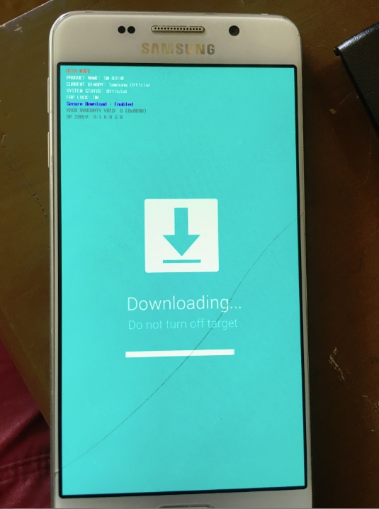

DOWNLOAD MODE ULIT
OPEN ODIN
CLICK AP (LAGAY MO NAMAN UNG FLASH FILE FOR A310F/A3 2016 NA NADOWNLOAD MO)

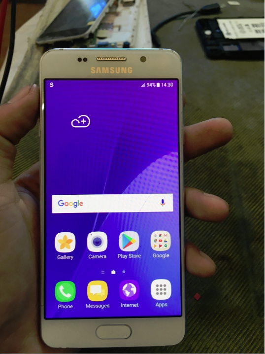

OK NA YAN KUYS, SINGILIN MO NA TOMER :)
PA RESPONSE NA LANG BOSS AND HIT THANKS KUNG NAKATULONG SA INYO
