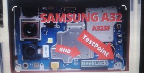

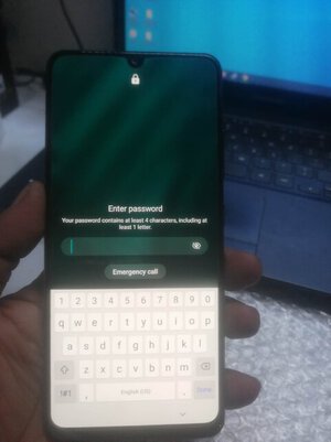

samsung A325F password problem done
(walang hard reset)
(walang dial *#0*#)

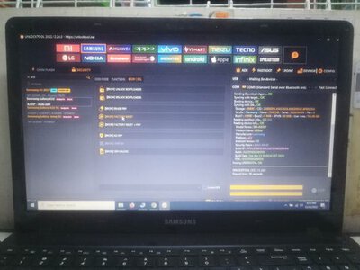

open unlock tool
click samsung tab
select model samsung a32 testpoint brom
click brom factory reset
remove muna battery then connect testpoint at kapag na read na ni unlock tool kabit battery na para walang FAIL

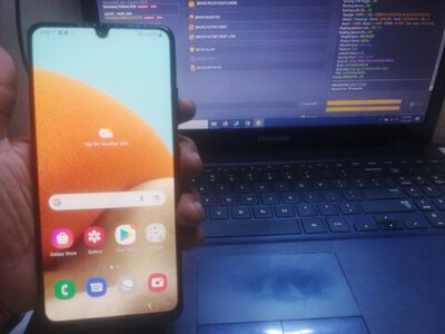

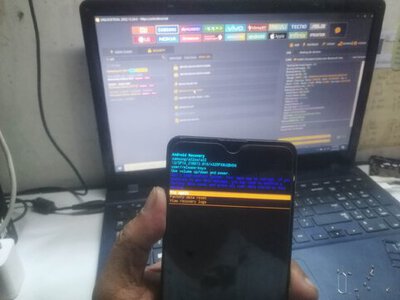

hintayin lang matapos si unlock tool then pag reboot ng unit manual factory data reset
1 press vol down
1 press power button
1 press vol down ulit
1 press power button ulit
done.
