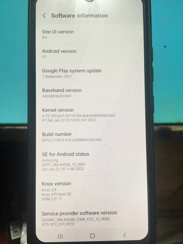

History: nireset daw nila at di na nila alam google account

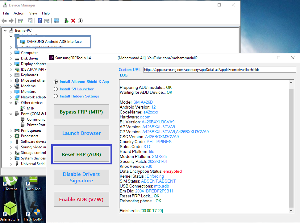

1. Open Samsung FRP Tool v1.4
2. Connect Phone to PC
3. Tick Install Alliance Shield x App
4. Click Bypass FRP [MTP]

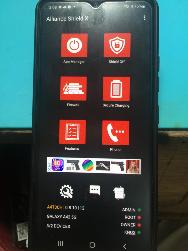

5. Download and Install Alliance Shield
On the Phone Setup Alliance Shield
Note: Dapat po may Alliance Shield account po kau... kung wala, register na lang po kau

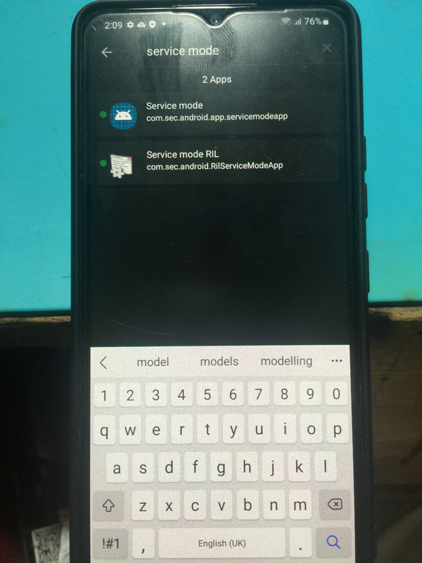

Open Alliance Shield
Tap App Manager

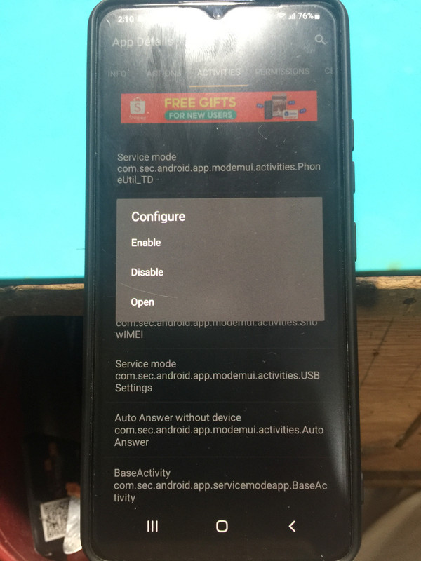

Search Service Mode - Open

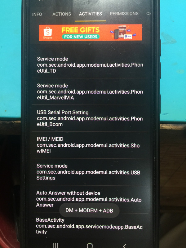

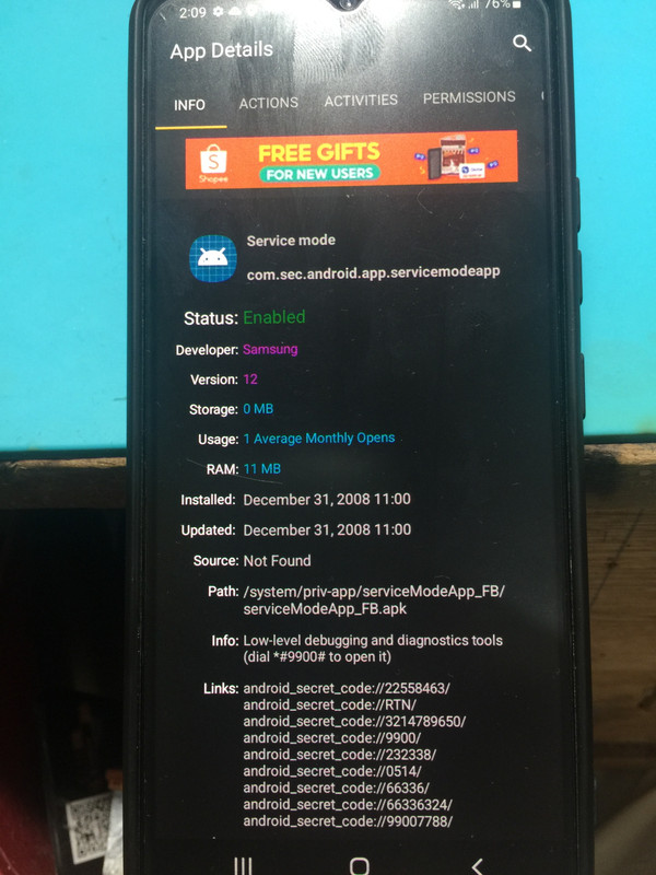

Go to Activities
Scroll Look for Service Mode Tap and OPEN

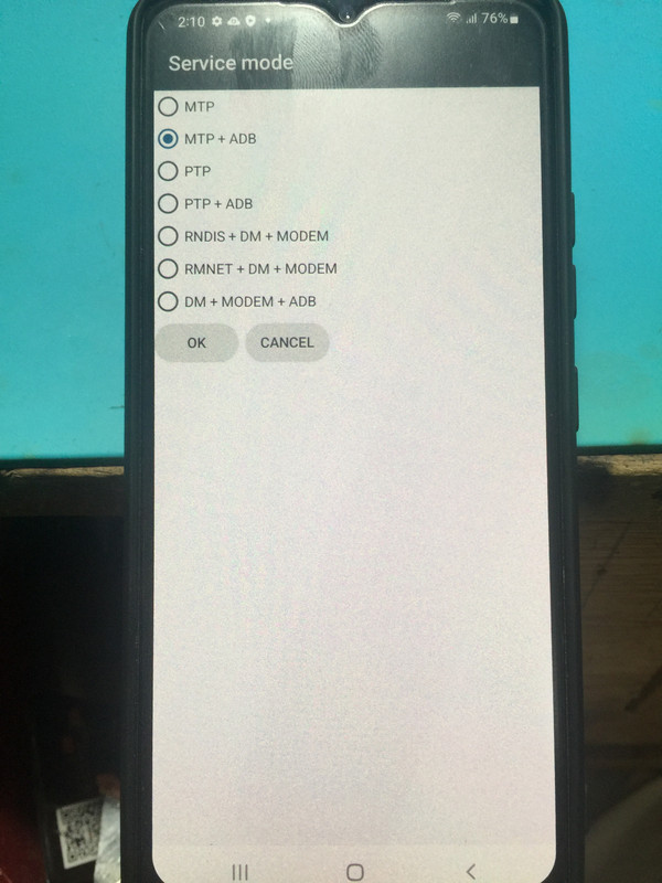

Select DM+MODEM+ABD
Connect to PC
Reset FRP [ADB]

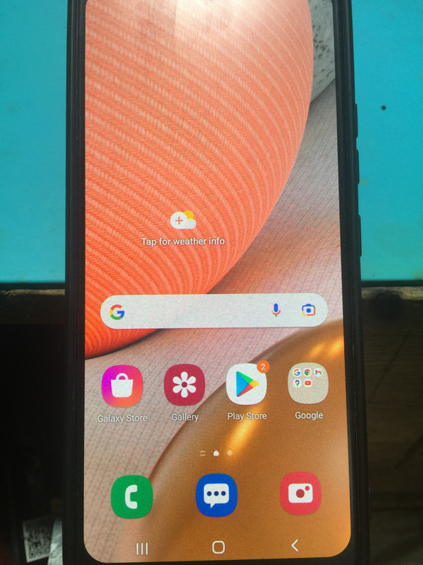

Ito na po siya pagkatapos.....
Note: Hang ng mga 5 mins ung phone .. pero hayaan nyo lang po... babalik din...
