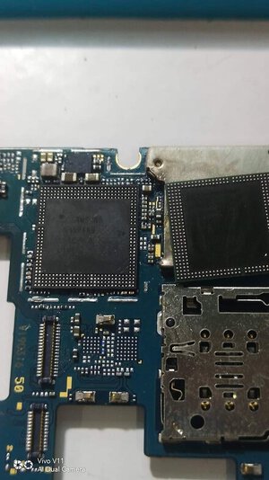

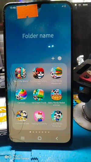

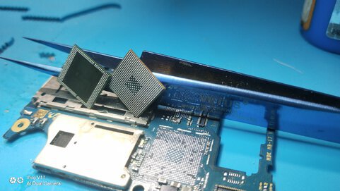

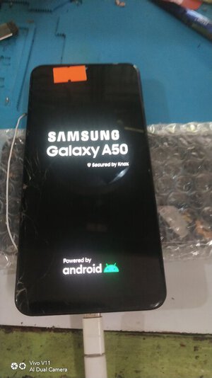

activa2r Administrator Staff member Joined Oct 30, 2022 Messages 714 Reaction score 2,654 Points 241 Location Leganes , Iloilo Nov 1, 2022 #1 For Reference lng mga boss.. Samsung A50 No Power from other shop. Sinubukan na reheat CPU.. Labas mga lead kaya rekta na reballs cpu and ram.. ganyan po status pagtanggap.. Done po data preserved mga boss.. Sana makatulong..

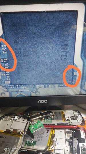

tris_edz Premium 2024 Joined Nov 18, 2014 Messages 179 Reaction score 13 Points 1 Location CELLWORKS, BURGOS STREET ,ORMOC CITY, LEYTE, Nov 9, 2022 #8 https://pinoytechnician.com/attachments/fb_img_1667313952847-jpg.13424/ ano po sekreto dito boss sa pagtanggal para di mawala mga lead jan sa gitna ng butas2x na ic na yan?
activa2r Administrator Staff member Joined Oct 30, 2022 Messages 714 Reaction score 2,654 Points 241 Location Leganes , Iloilo Nov 9, 2022 #9 tris_edz said: https://pinoytechnician.com/attachments/fb_img_1667313952847-jpg.13424/ ano po sekreto dito boss sa pagtanggal para di mawala mga lead jan sa gitna ng butas2x na ic na yan? Click to expand... di po nawawala mga lead jan idol.. anjan lng po yan kailangan mo lang linisin mabuti bawat butas kasi natatakpan ng glue residue.. kaya di po nawawala.
