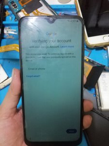

Mga boss share ko lang, Samsung A50s FRP remove using hydratool. Sa ngayon ang alam ko supported ng procedure nato lahat ng Samsung na mat test mode via *#0*#

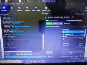

- sa emergency call dial *#0*#
- Open mo hydra main tool
- select Samsung tab
- Sa service tab ni maintool select FRP 2022
- Click execute
- connect your phone still in test mode.

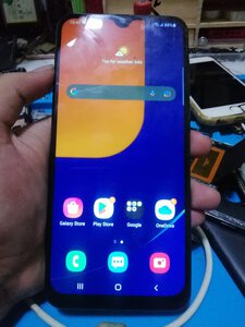

- wait hangang matapos gaya ng nasa pic.
