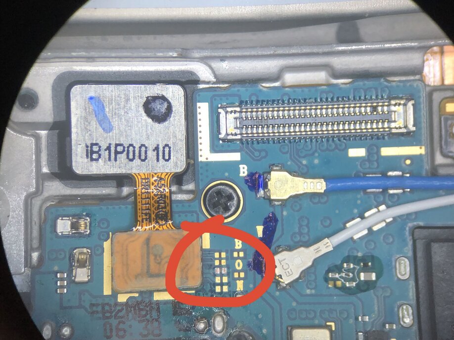

From other shop na for CPU Reball sabi ng tech..
di pwede software importante files..
ilang beses na rin ako nakakagawa nito..

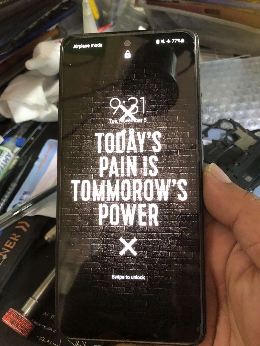

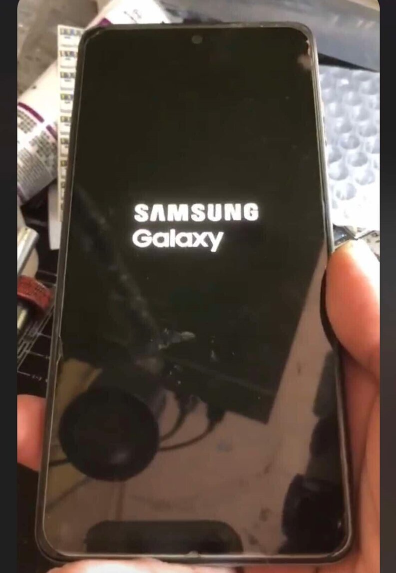

status stuck lng jan at restart
disassemble phone then try new lcd same pa rin
disconnect fpc ng sub board aba tumuloy hanggang menu
at hindi nag rerestart at working lahat.

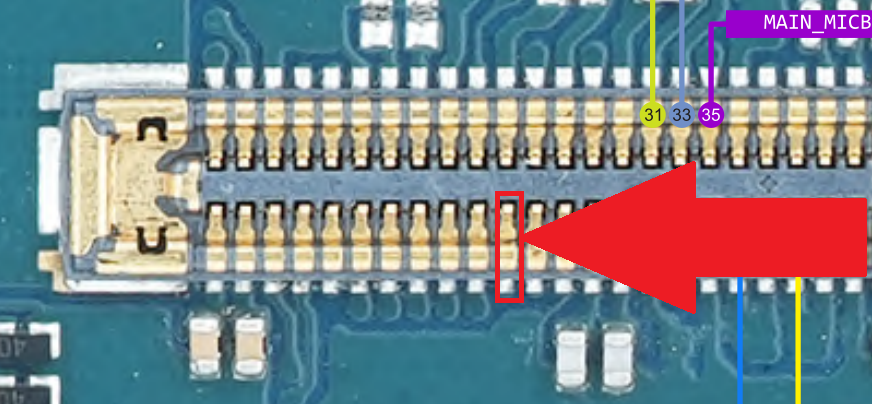

diode mode dito sa 3.3v supply ng sub board for finger print
kung shorted sa ground...
kapag shorted alams na remove lang capasitor
ito yun..
done..
ugaliin lagi mag troubleshoot
save time and effort wala rin risk...
sana makatulong..
