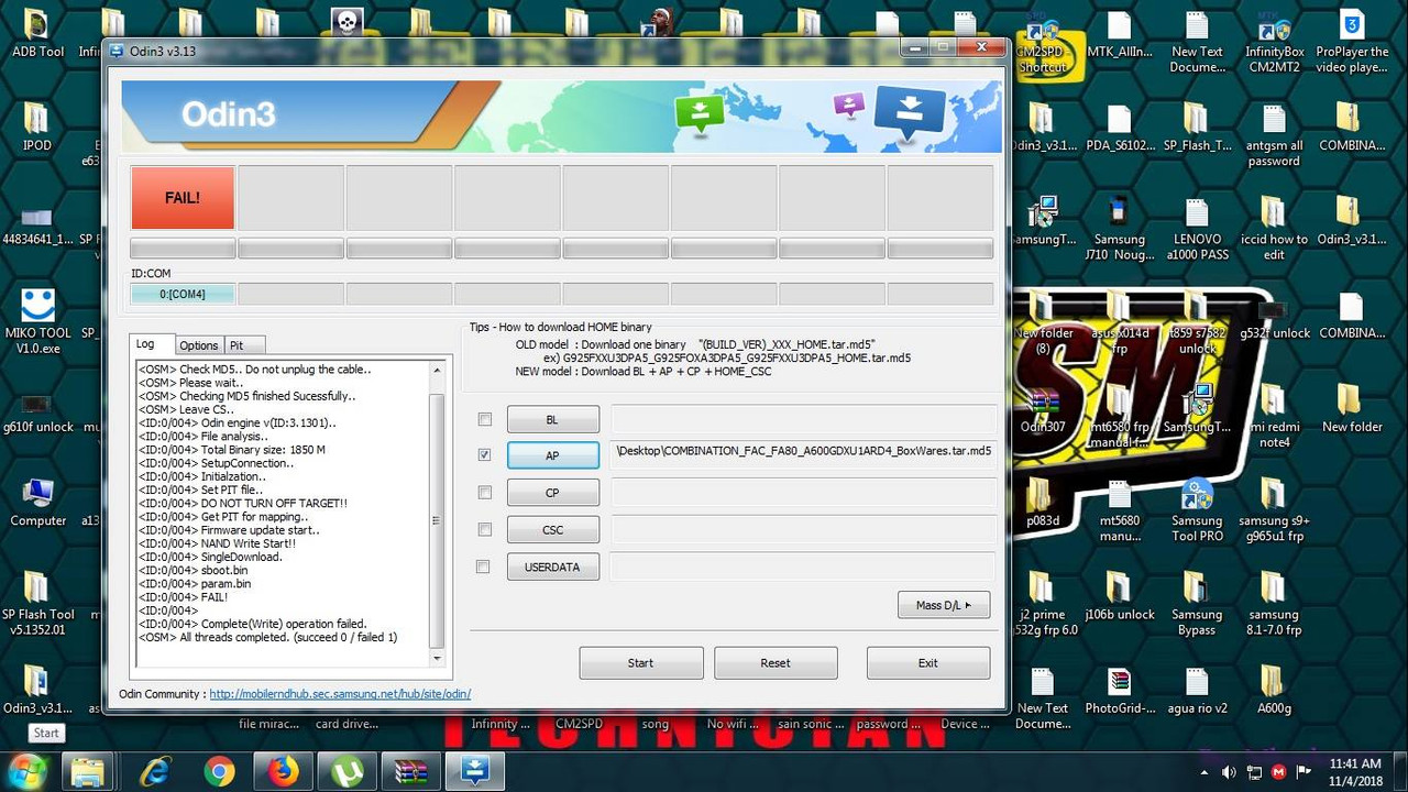

share ko lang samsung A600 frp pahirapan pagdownload sa combination 1,2,4 file puro error

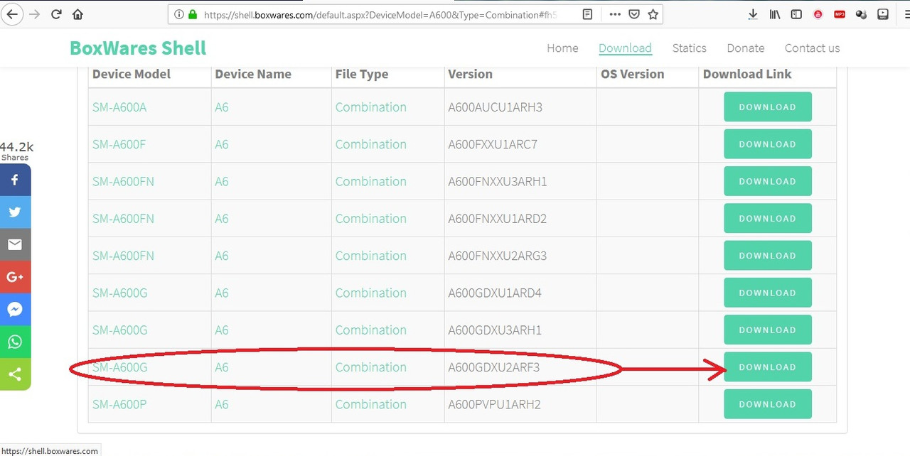

kaya hanap ako kay uncle google solution at di naman ako nabigo, dito ko nakuha combination file...
https://shell.boxwares.com/default.aspx?DeviceModel=A600&Type=Combination#fh5co-table

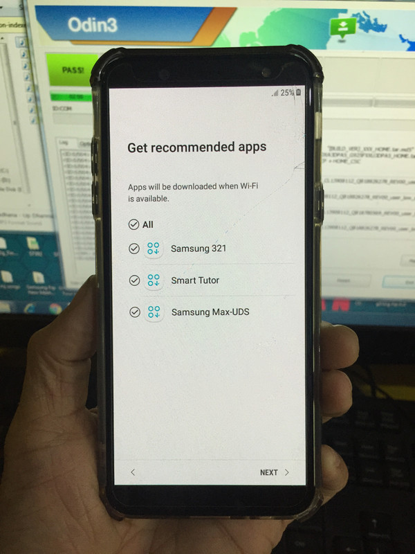

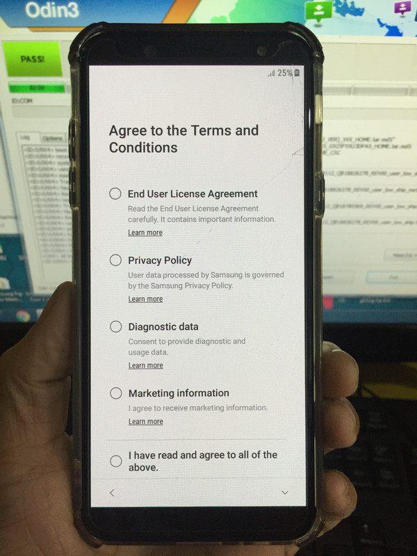

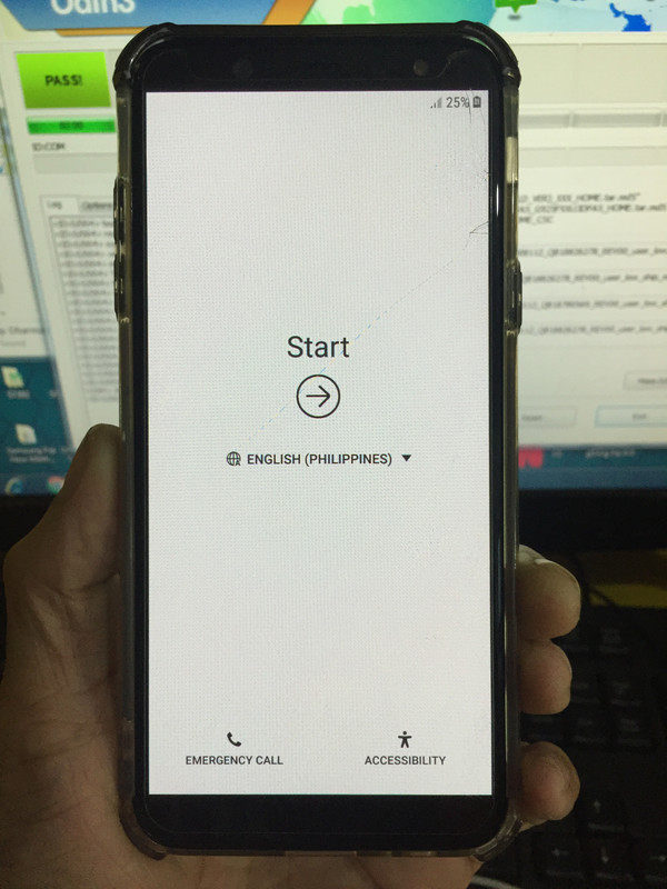

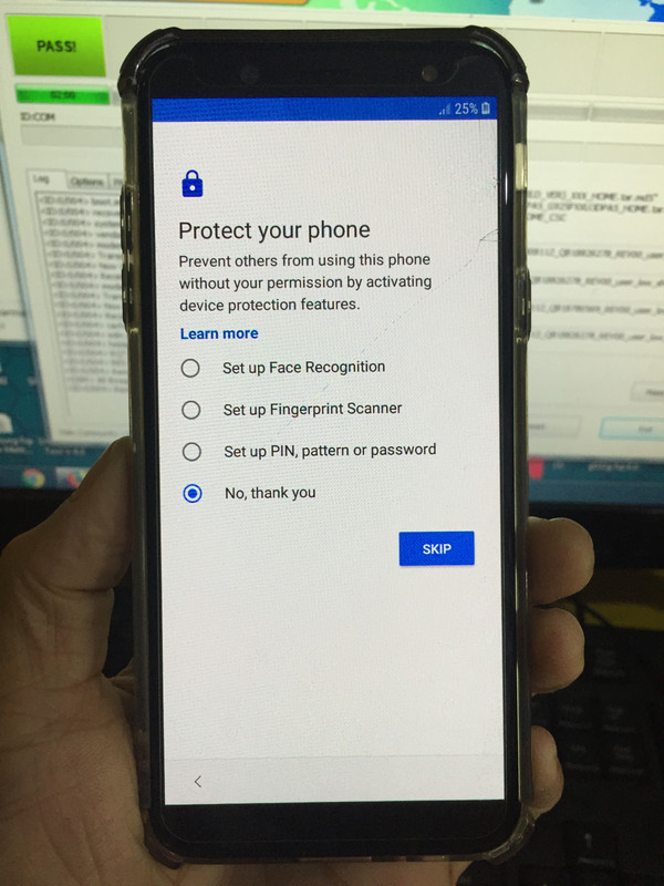

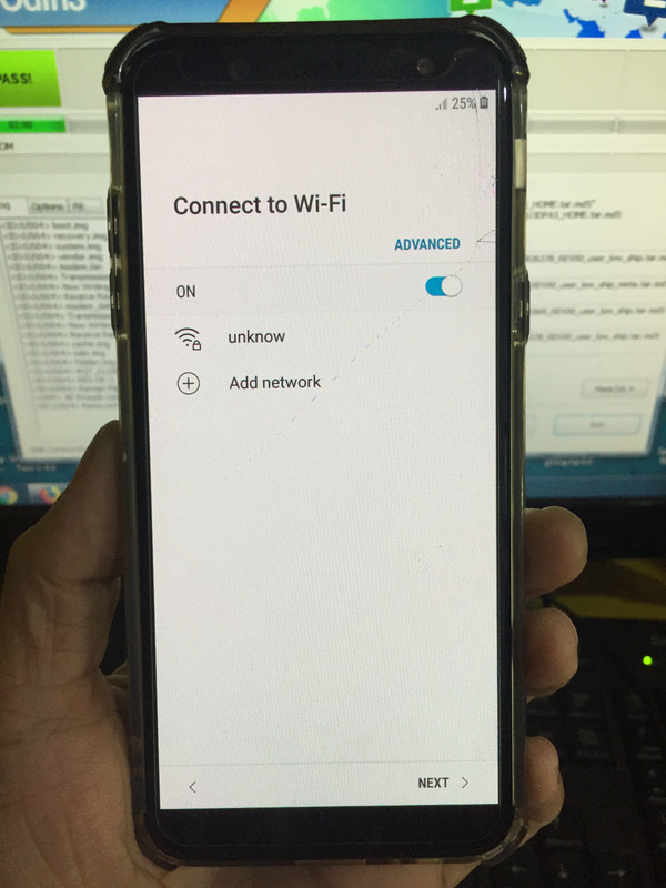

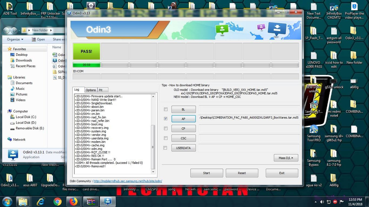

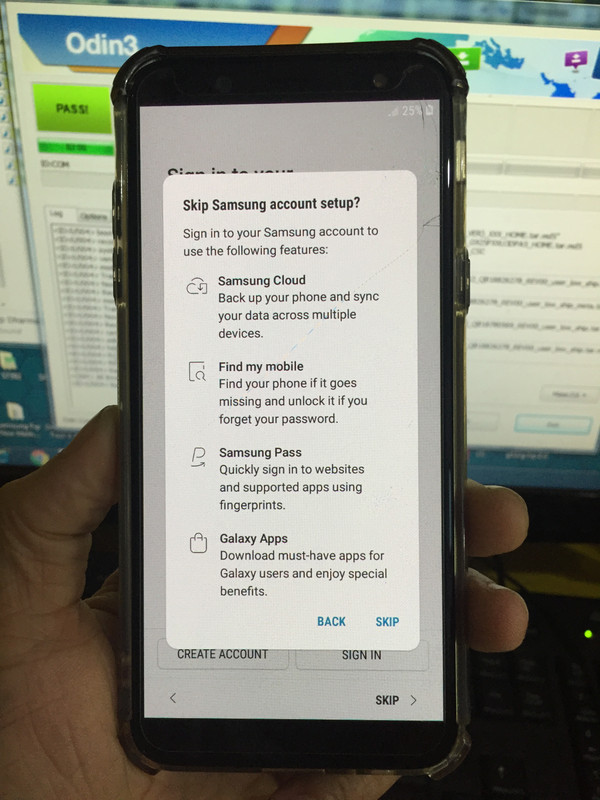

flash ulit using combination file at ayon success na...
goto setting on lang oem unlock...
then goto download mode:

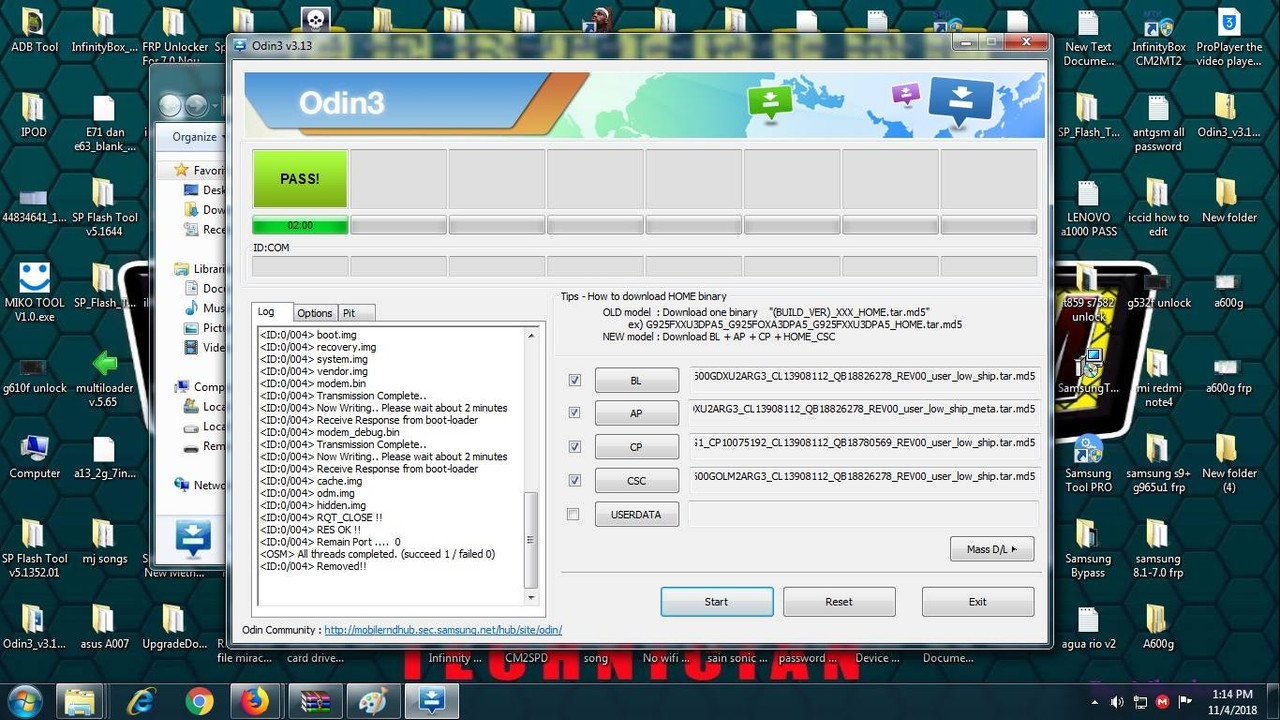

full flash ang unit dito ako kumukuha ng firmware kasi tested mga flashfile dito!
https://www.sammobile.com/firmwares/

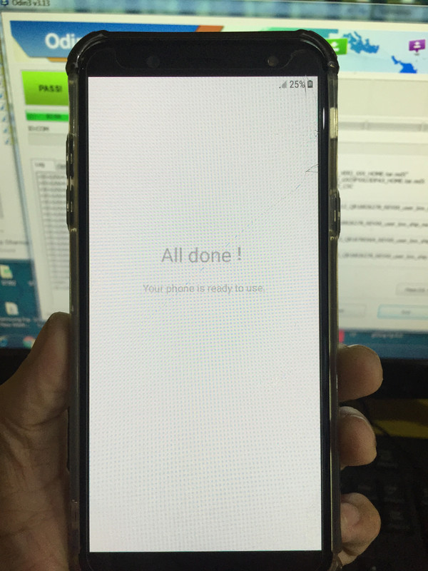

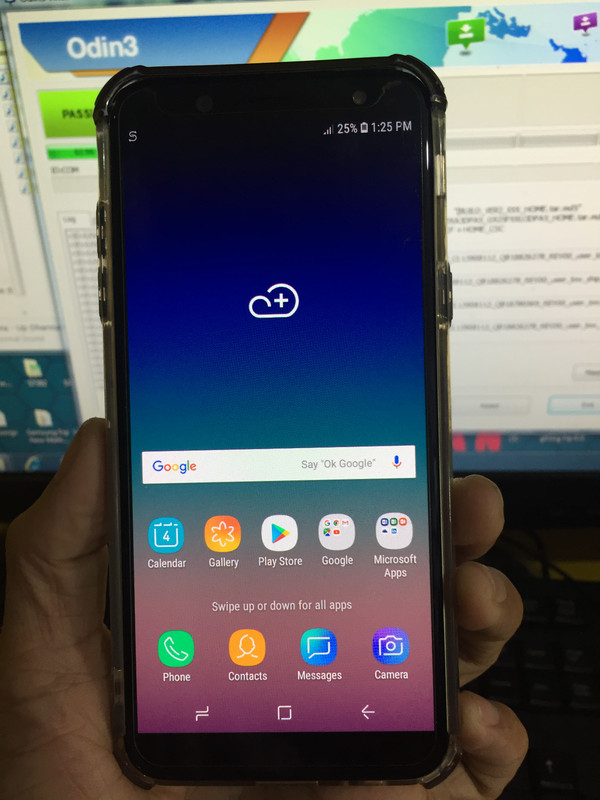

select BL.AP.CP. CSC HOME lang ilagay
Wait until finish...DONE
